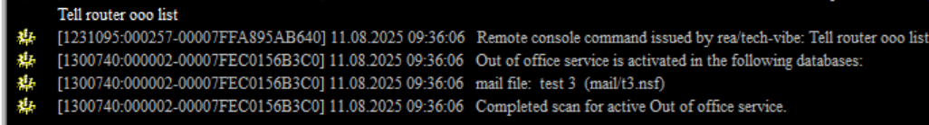

Run ‘Tell router ooo list’ and check whether the user entry shows in the list.

Hello, SudhakarReddy
Yes, there is a record. Restarting the router does not resolve the issue.
