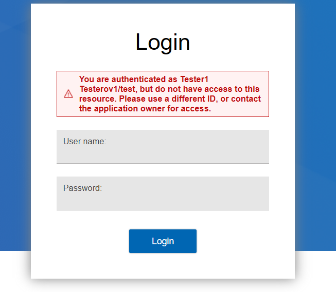

There was a problem when configuring domcfg.
The problem is as follows:
1 - HTTP is configured for ‘Bearer token (JWT)’ authorisation. Keycloak acts as a provider.
2 - A form is configured on the server in domcfg.nsf - Error & Response Form Mapping to handle ‘Authentication Failures’ and ‘Authorisation Failures’
3 - The user is authorised on the server and opens their mail file. All is well.

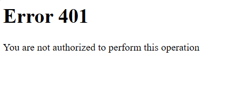

4 - Next, the user wants to open a mail file they don’t have access to and gets a default authorisation error. I am attaching the screenshot.
5 - At the same time when trying to open for example log.nsf or certstore.nsf, to which the user also has no access, the user gets errors based on the domcfg.nsf configuration.

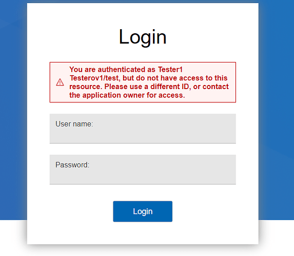

6 - If I disable ‘Bearer token (JWT)’, then when performing the same actions, the user always gets an authorisation window as in this screen.
Is it a Domino error or something wrongly configured? Why doesn’t ‘’Error & Response‘’ Form Mapping from domcfg.nsf database work?
