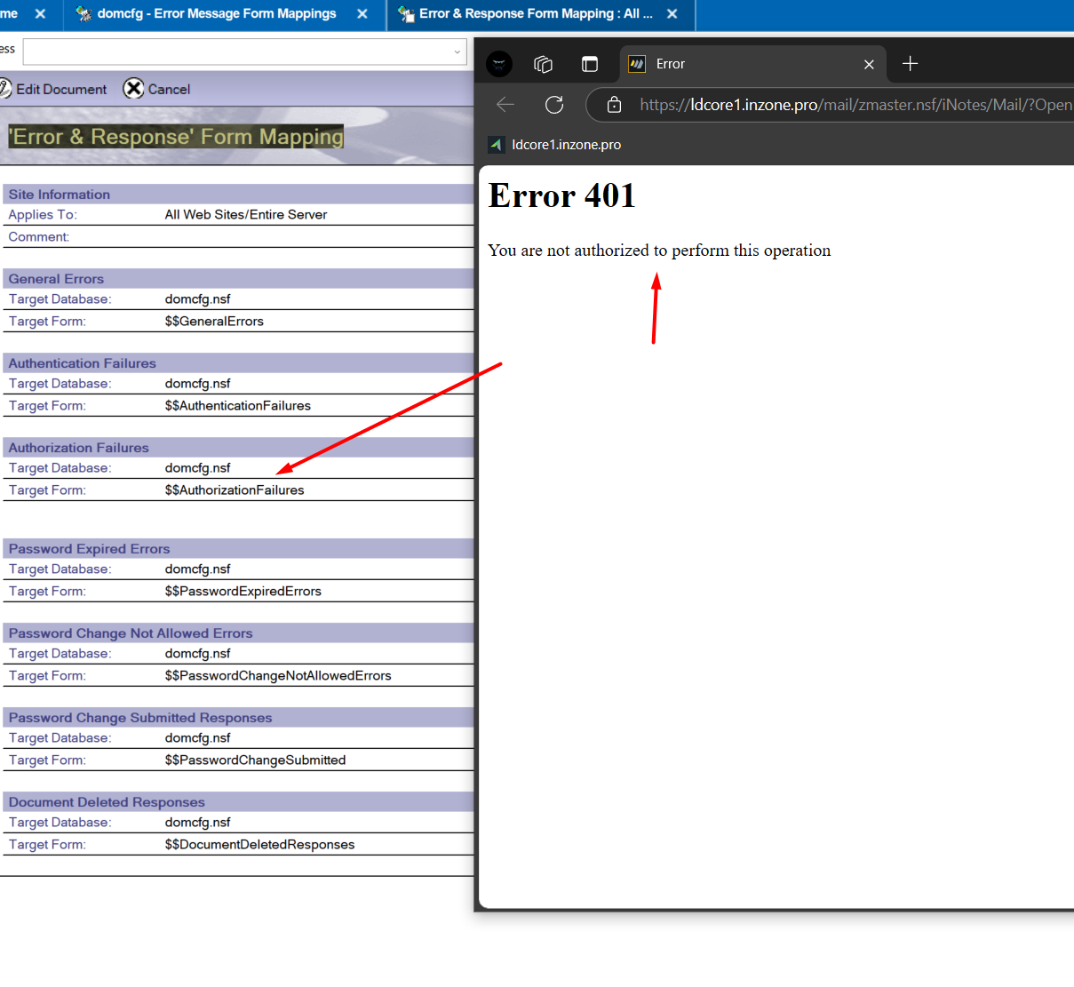

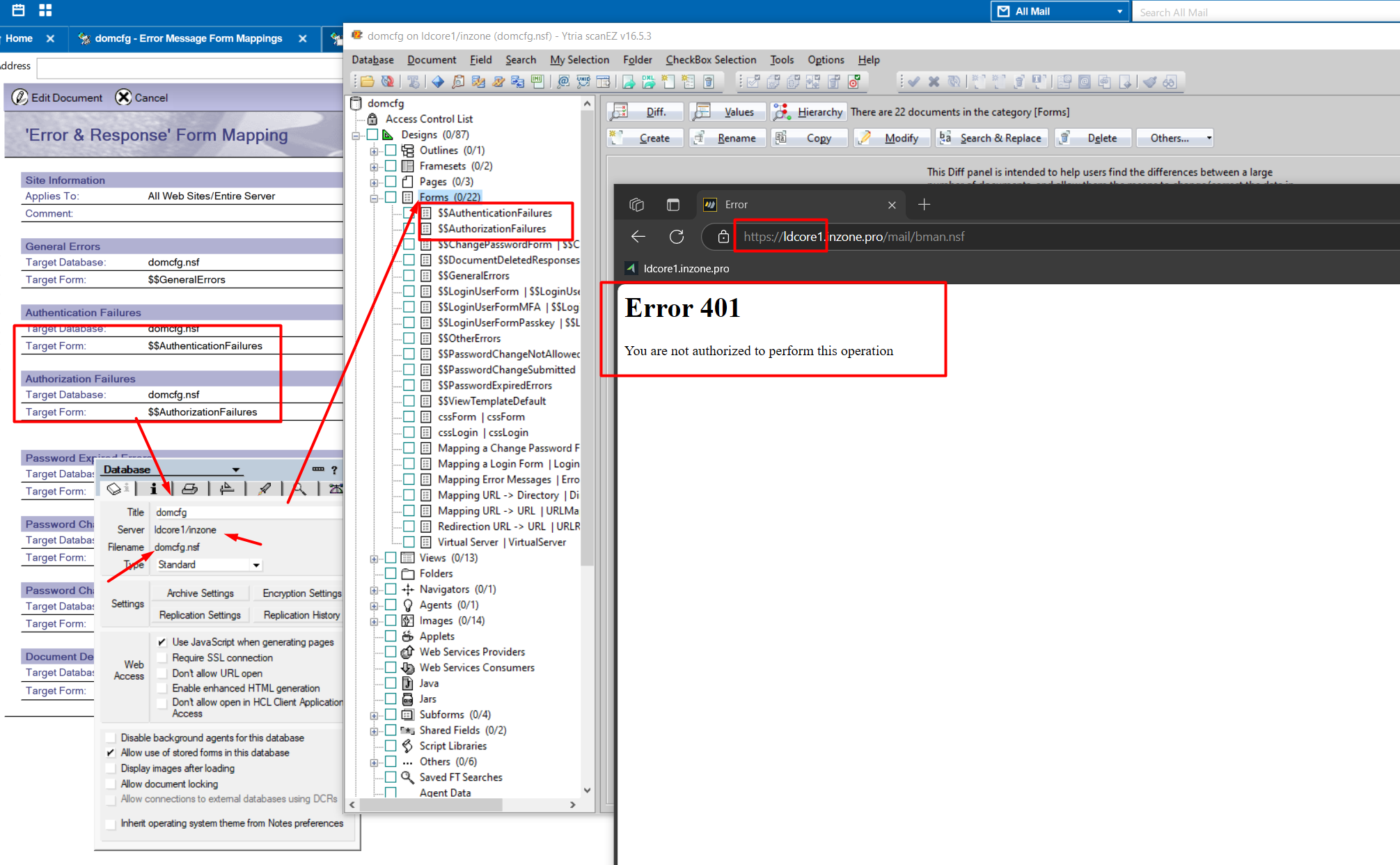

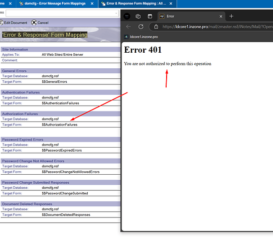

Hey, everybody. Can you tell me what I'm doing wrong? On the server created a base domcfg.nsf, configured forms with errors, but, when trying to open the base to which there is no access comes out the standard error 401. Customized error does not appear. What is wrong?

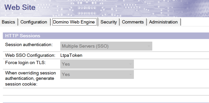

In my tests, I use SSO. It doesn't work that way (

Domcfg is on all servers and is a replica. All forms are on all servers. But it doesn't work. I've already racked my brain. Maybe it's a bug?

I tested with single server session auth as well as saml auth. Auth failure does not fire the relevant error form. All other cases it works. Most likely a bug unless we are missing some additional setting.
However in above two cases it offers the login form and not 401
