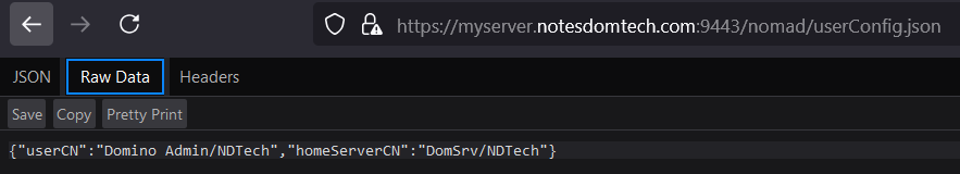

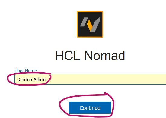

The URL https://mynomad.acme.com:9443/nomad/userConfig.json will only work after user is validated on the server when you click on "Continue" after entering the user name in the below window.
In another tab when you hit https://mynomad.acme.com:9443/nomad/userConfig.json it shows as below.

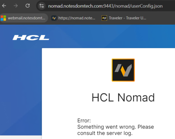

Without the validation of the user on the nomad server. You will see the message "Error:
Something went wrong. Please consult the server log" as below.
