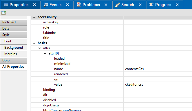

I have defined an attribute "contentsCss" in several Richtext fields in several XPages applications on my servers. This worked fine for many years...

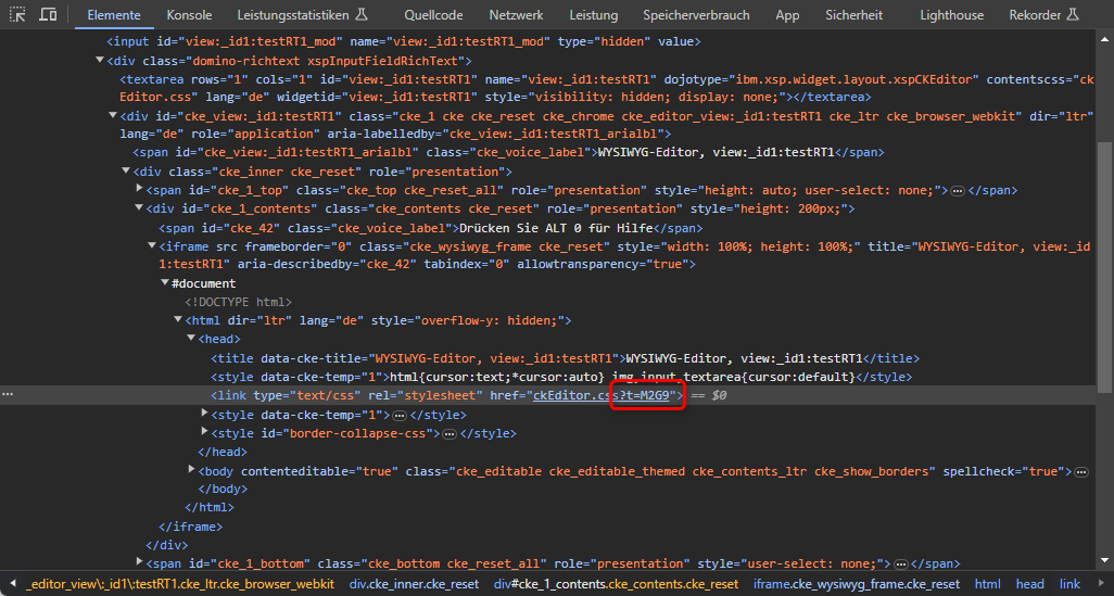

But since a few weeks time it doesn't work anymore. After some investigation I figured out that this incorrect reference in html is the problem:
If I remove the addition "?t=M2G9" everything works again...
Does anybody know the reason for this additional "parameter"?

This seems to be default CKEditor behaviour to append a URL query parameter with the CKEditor timestamp value. See https://ckeditor.com/docs/ckeditor4/latest/api/CKEDITOR.html#method-getUrl.
In the source for the code that appends the timestamp it says: "Leaves the URL unchanged if it is a directory URL or it already contains querystring parameter."
So try changing your CSS URL to include a querystring parameter that Domino understands (for instance ?open).
Thanks, Per, that (workaround) did it!
I thought in that direction yesterday, but didn't come up with the idea of "?open" 🙄
