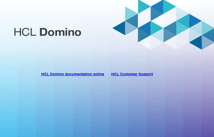

I recently upgraded a test server to Domino version 14, from version 12. It is a Windows server and we have SSO set up for web authentication. After the upgrade, the web page that appears after authentication is now the server home page (/homepage.nsf?Open), and not the form or page that we log into. If I enter the url of the form or page that I originally logged into, it loads and I am logged in to the server successfully. But, I am not sure why it goes to the server home page after initial authentication? I am hoping this is a simple setting somewhere that I am missing. I have included an image of what appears on the page after log in. Thank you for any assistance you can provide.

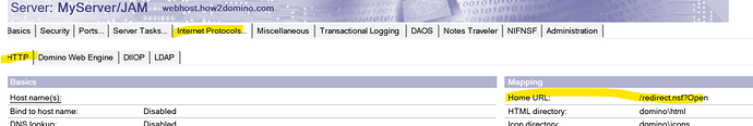

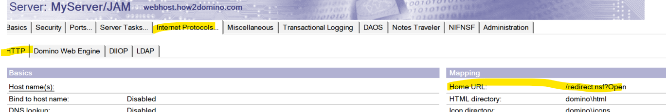

Server document:

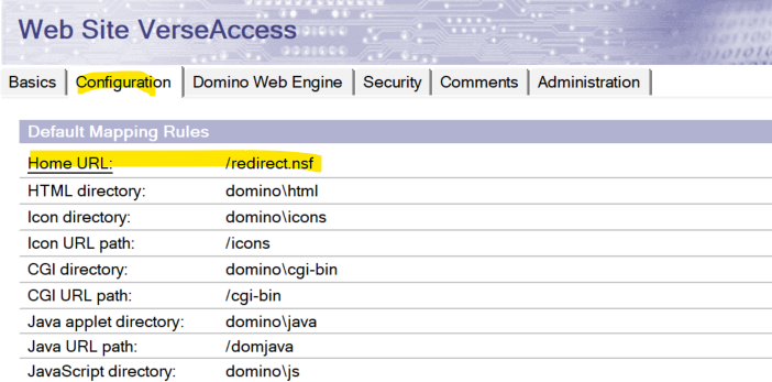

Internet Site document:
If it is homepage.nsf in the Home URL, then you need to set this to your custom database name.

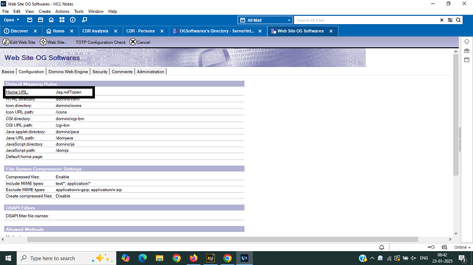

The default page that opens after authentication would be found under configuration in internet site document (if you are using one) . else it will be there in configuration in server document under internet protocol. replace the /homepage.nsf with your login page url.

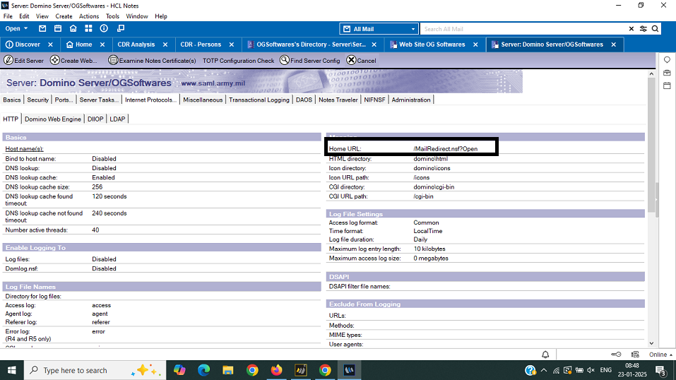

In case you are not using internet site document then make the changes in server docuemnt as under
