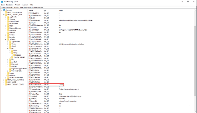

Hello Michael,
if you are installing on a Windows Platform, I found that for me the easiest way was to read the version from the windows registry. Some windows client management software can access it "natively" so this was usefull for me.
Take a look at the following Keys in registry:
HKEY_CURRENT_USER\Software\HCL\Notes\Installer\NOTESVERSION
Best regards,
Milan

Hi Michael
You can use below LotusScript code to get the Notes Client version from Registry.
Dim Ret As Variant
Ret = Evaluate({ @RegQueryValue("HKEY_CURRENT_USER"; "SOFTWARE\\HCL\\Notes\\Installer"; "NOTESVERSION") })
Msgbox Ret(0)
