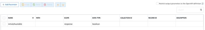

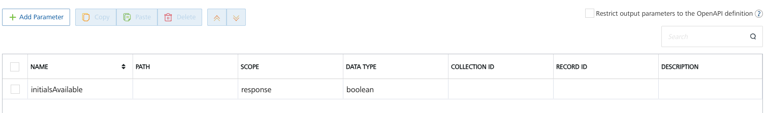

Now we want to define our own output for the service but we cannot get to build a working mapping.
If we use the following:
We don't get the initialsAvailable value in the response

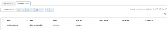

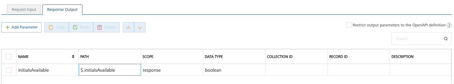

If we use the alternate below:
We get an error in the log:
  1. {
  2. "Performance (in ms)": {
  3. "BACKEND_REQUEST": 546,
  4. "PRE_PROCESSOR": 23,
  5. "POST_PROCESSOR": 5,
  6. "contype": "OpenAPIAdapter",
  7. "REQUEST_MAPPER": 0
  8. },
  9. "Logs": [
  10. "[server.console][ERROR][2025-01-27T18:43:33.506+01:00]:[63e73740-c11f-4c6c-968f-6103134867e9]:[]:[]:[http-nio-8080-exec-148]:[ALERT.com.konylabs.middleware.connectors.json.JsonPathEngineImpl:error:93]:uuid=\"07026da95753426f9287b03144f382c1\",dim=\"A\",level=\"ERROR\",comp=\"TEMN-QF-Server Console-com.konylabs.middleware.connectors.json.JsonPathEngineImpl\",cn=\"com.konylabs.middleware.connectors.json.JsonPathEngineImpl:readPathFromDocumentContext:255\",\"QF\":TL=\"Log\",msg=\"No record found in the given path: No results for path: $['initialsAvailable']\""
  11. ]
  12. }

Hi Daniele, you are getting that error because the path you configured ($.initialsAvailable) does not exist in the output of the service from the backend. Please check that. If this parameter does not come from backend but you want to include it in the final output of the result, you can add it in the post-processor the way you already tried. Not sure what you mean by working map. Please explain so we can guide you further.
I confirm that initialsAvailable does not exist in the backend service.
My expectation is that by adding the parameter in my postProcessor I can then reference it in the output.
