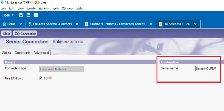

Please share the below URL how to create a connection document programmatically.
https://support.hcl-software.com/csm?id=kb_article&sysparm_article=KB0077904
Change the value of field name in sample code provided in this article to keep value as per your environment.
I am hoping that below fields are your area of interest in connection document.
Call uidoc.FieldSetText("Destination","TEST/ORG")
Call uidoc.FieldSetText("OptionalNetworkAddress","x.x.x.x")
I hope this could of some help.
As you have said that you do not want user intervention, you can wait for other responses as well if this is feasible.
