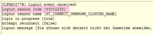

What could caus error "[ST_CONNECT_UNKNOWN_CLUSTER_NAME]"
Hi.

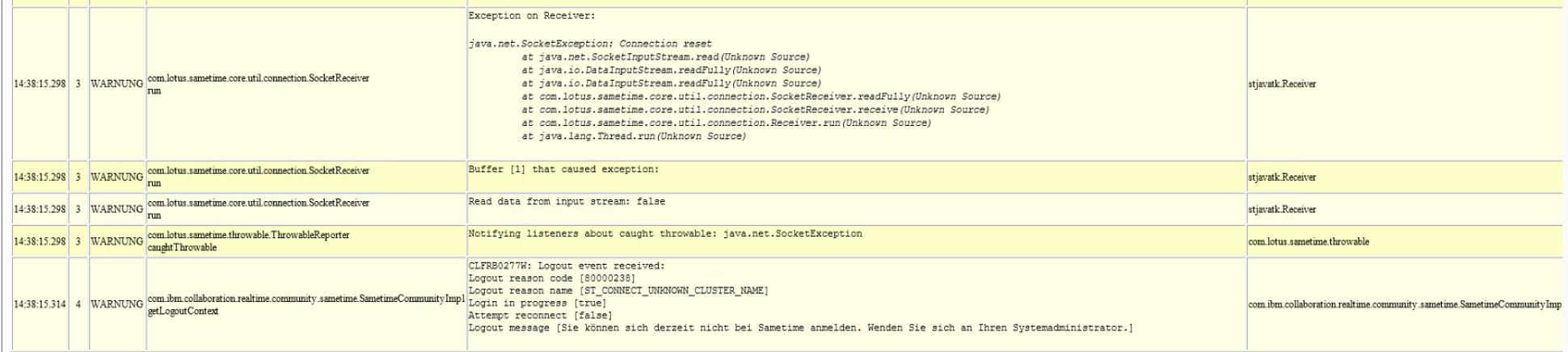

Has anybody an idea what could cause the errors in the screenshot?
Is there realy an issue with the connection to the server? I can open a database on the server without a problem using Notes.
Some more Information: Domino 11.0.1 FP1 and Sametime 11 FP1 Limited Use on Windows. No Cluster. Just a single Instance.

the error is a connectivity error
Per the following article
Explanation of error codes associated with Sametime Community Services
This error is thrown when trying to redirect the user to a cluster that is not configured for the server.
Review your Configuration
See the following documentation Clustering Community Servers
and check if you have some setting in place, that might trigger the redirect to a cluster.
above the lines that you provided, you should see what server the client tried to connect to
is it going to the correct server initially?
if you cannot find anything then open a case with Support, as we will need to review your
configuration and possibly enable additional debut
let me know if this was helpful
