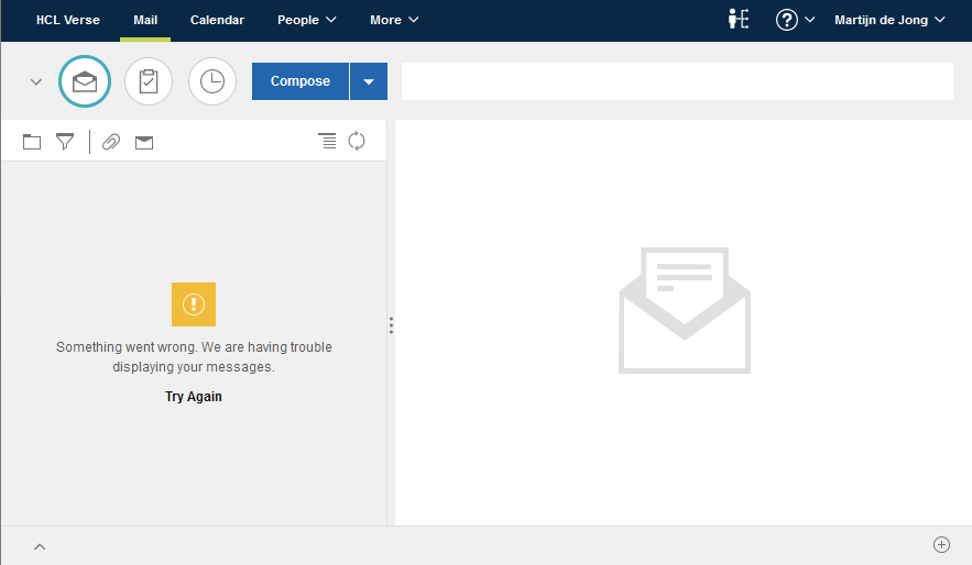

I have a weird problem that maybe someone else recognizes and solved. On my Domino server (12.0.2 EAP3) I have Verse 3.0 installed. If I connect straight to my Domino server both iNotes and Verse work just fine. However, if I connect to my Domino server over my reverse proxy, iNotes works fine, but Verse fails to load the inbox
My reverse proxy is an nginx server. Relevant proxy settings are:
location / {
proxy_set_header X-Real-IP $remote_addr;
proxy_set_header X-Forwarded-For $remote_addr;
proxy_set_header Host $host;
proxy_set_header X-Forwarded-Proto $scheme;
proxy_pass https://192.168.7.100;
Does anyone know what I'm missing why the Verse inbox doesn't want to load?

Open the developer tools of your browser (F11 most likely):
  • Are there error messages on the console tab?
  • Are there request in the network tab, which get a timeout or error?
I assume, there will be some requests with errors in the network tab. There you see the error code, the URL requested, cookies sent with the request etc. A lot of info to go forward...
I wrote a blog article about the issue: https://blog.martdj.nl/2022/08/26/nginx-as-reverse-proxy-on-centos-9-stream-a-problematic-combination/
It had absolutely nothing to do with Verse, but with a mismatch between the versions of OpenSSL 3 and Nginx on CentOS 9 Stream.
