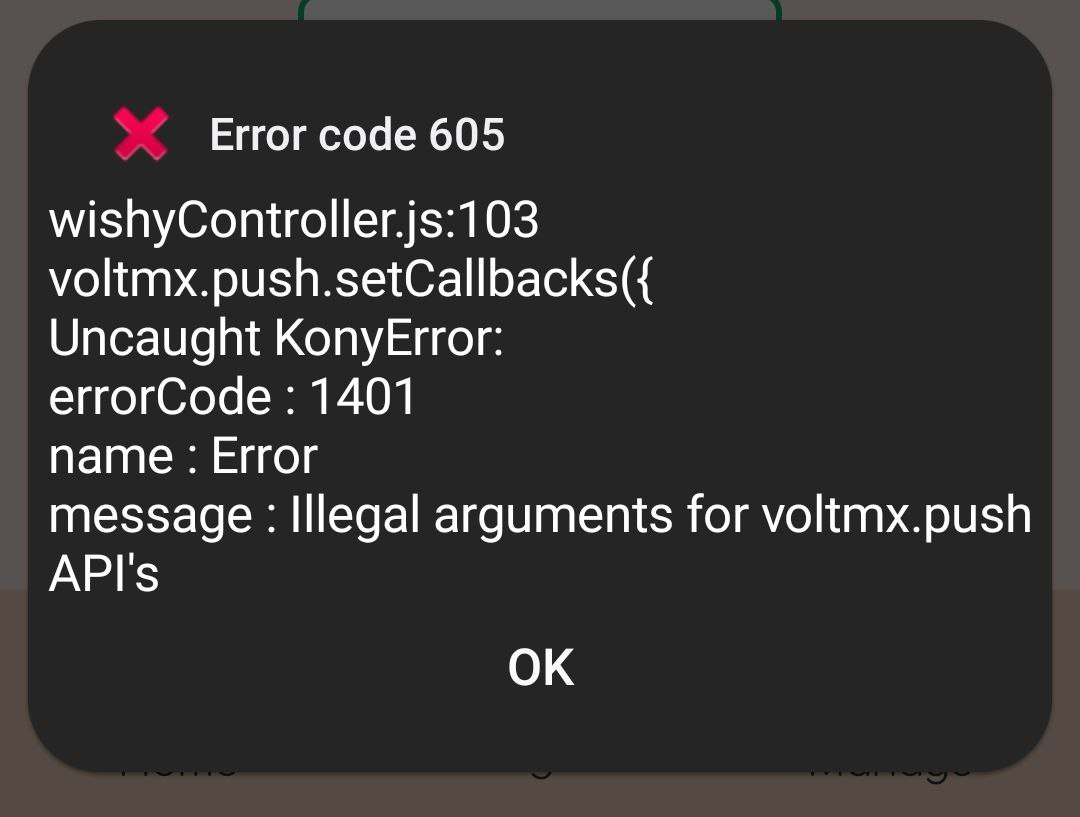

@Pratiksha Shetty, I am getting Error code 605
What is wrong here. because I am not even calling the function to register the device for push notifications. I guess there are some syntactical issues.

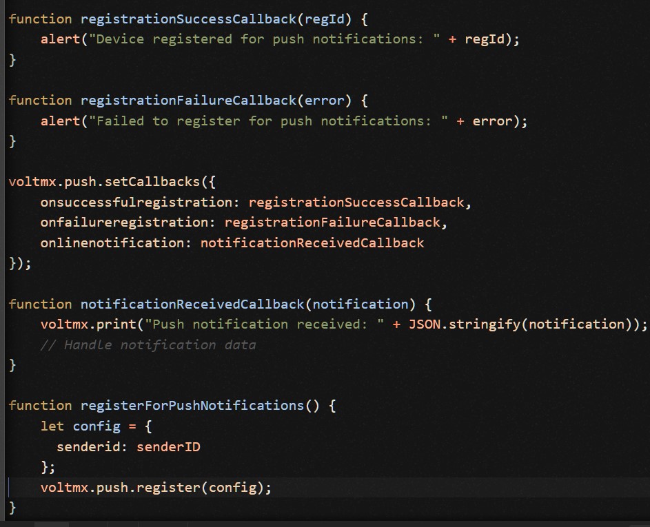

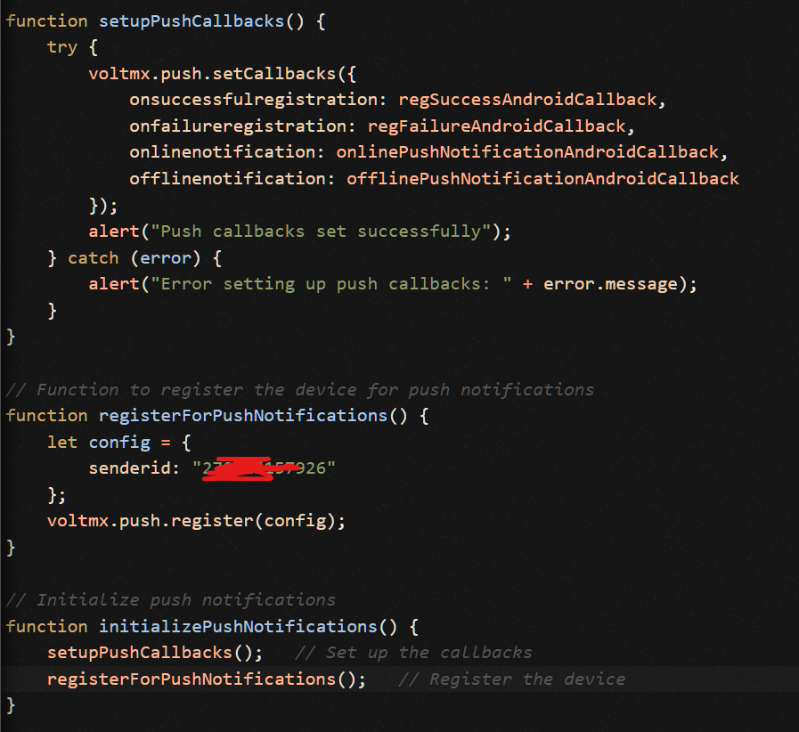

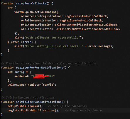

I am using this code to set up FCM push notifications on an actual device. As of now, I have added the service account private key in the Engagement section of Foundry.
Now, I am facing a weird issue. If I call setupCallbacks(), then I get the 605 (Illegal arguments in the voltmx.push APIs) and 103 (Performing operation on a reference that doesn't exist) errors. What am I doing wrong in setting the callbacks?
If I omit the setCallbacks function and directly run the registerForPushNotifications(), then I do get the Allow Notifications alert in the apk. but it doesn't do anything as the callbacks are not set.
What am I missing, do I have to add permission, or stuff in the gradle file? What to do? Can anyone help?

If you haven't done this already, can you try adding the following to the build.gradle entries to Suffix in the Native -> Android Mobile/Tablet -> Gradle Entries section?:
dependencies {
implementation 'com.google.firebase:firebase-iid:21.1.0'
Nope, it also didn't help @Nina Brown. It's really weird to see that the thing is working fine for the preview, while the same is not working via the APK. Even no error is showing up.
By the way, there is no need to use the google-services.json file in the project directory?
