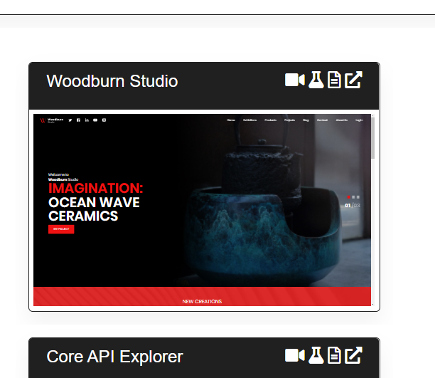

If I copy the link to access the woodburn studio, from the demo pack:
I get:
https://dx.sbx0106.play.hclsofy.com/wps/portal/demo/!ut/p/z1/hY_NboMwEIRfpU_A7mKw6RFVUdX0R2pFEvAFGXAcFGJH1KTK29f9OQVF2dvufLOjAQklSKtOvVG-d1YNYa8kr9kjLYghEa1EjO9vBUsWxRrxmWBzC5BBxiuTI6xBgvw61q2vjXbtTrd73UHlx0n_KB4qjDDlAklgnMQ8Y_eJCKny1uMlSDO45q9DbhuWmXDRLhpCNz91GkqWRUSYzgBnzT9BacQ5sUuidZP14xnKp-JS-vTKB6PIZp7eB8OHNqZ3dw9qUM3Yqxm023dQ_pY_HlaHjPHtq0-bMxtOL3qTfwPMFMhZ/dz/d5/L2dBISEvZ0FBIS9nQSEh/?t=0.05670170242683947&wp_ct_geochecked=true#
All the character after demo in the URL, what are useful for, why there are, is there a way to decode and have a string that can be understood by humans?
