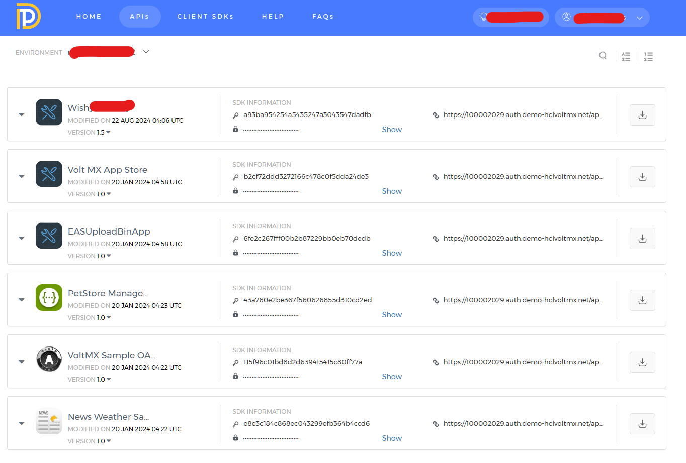

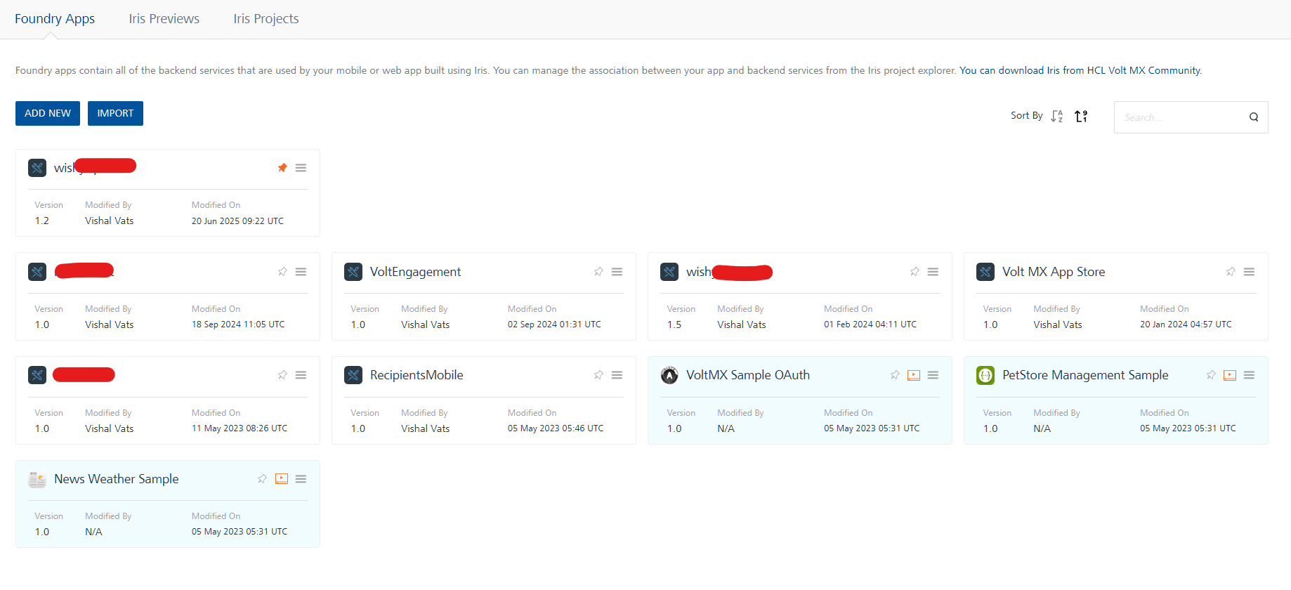

I have these many apps on my Foundry dashboard, but when I visit the Developer Portal, I can only see 6 APIs listed. So, how are these remaining not showing up there?
Any idea what am I missing?

There is a particular foundry app named wishyUpdated that is not showing up in the developer portal, even though I have published it multiple times (and even tried unpublishing it).
This is the only foundry app that has multiple versions. Does that cause an issue?

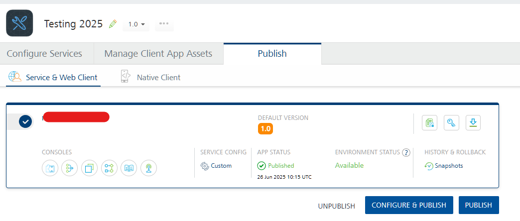

As you said, I created a new, dummy application in Foundry and even published it. But on the dev portal APIs section, I cannot see it

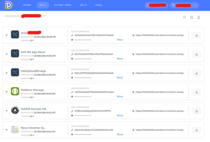

Tried the incognito mode, different browsers but nothing is working. So, for sure it does not seem to be an cache issue. All of my 8 foundry apps are puclished, but only 6 are being displayed there.
In the networks tab, I can see that the API call is only returning those 6 on the dev portal. I am not sure, why those 2 are not appearing here.

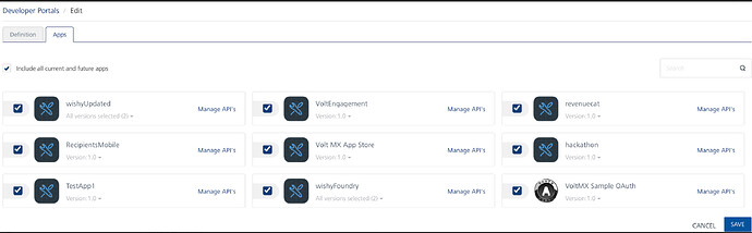

Thanks for providing access to the demo environment. Post checking we found that a setting is not enabled in your account ie “Include all current and future apps” in developer portal configuration settings
Thanks for pointing that out & finally solving this issue :white_check_mark:
Foundry console → Developer Portals (from the sidebar) → Edit the portal (via the three dots) → Apps
Just a curious question: Isn’t that seting enabled by default for the accounts, and if it’s disabled, does it only show a certain amount of apps on the portal?

The option should be enabled by default but it looks like it is disabled for your environment.Till the moment it is enabled you are able to find those apps in the developer portal.
