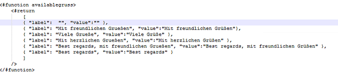

I define the drop down menue in the commonUtil.ftl.
Do I need a special character for umlauts in .ftl?

in a free text field it works with Umlauts. Only in the Dropdown menu i have the issue.

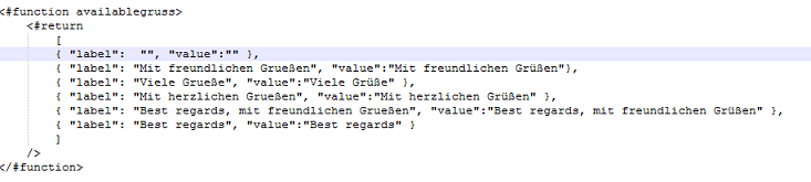

I have entered in the commonUtil.ftl the terms directly "Mit freundlichen Grüßen".
Should I deposit these in the ui_de.properties first?
How do I define Umlauts them in the custombundle?
Would that be correct in the commonUtil.ftl?
{ "label": bundleResource(custombundle, "Mit freundlichen Grueßen), "value":"Mit freundlichen Grueßen" },

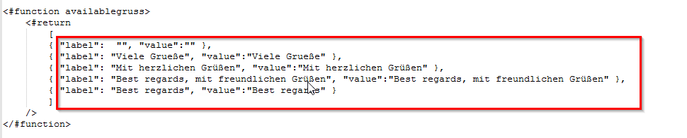

I would do something like this:
"label": "Mit freundlichen Gruessen", "value": "Mit freundlichen Gr\u00fc\u00dfen"
The ß is special too, so don't use it as a label!
I mentioned ui_de.properties to have a look into the different character replacements, or you look at https://www.fileformat.info/info/unicode/char/00df/index.htm
Unfortunately, it did not help to write the umlauts differently. Like e.g. \u00fc.
The solution in this case was to add the following custom properties in the JVM of the Infracluster.
Now the umlauts are displayed correctly.
