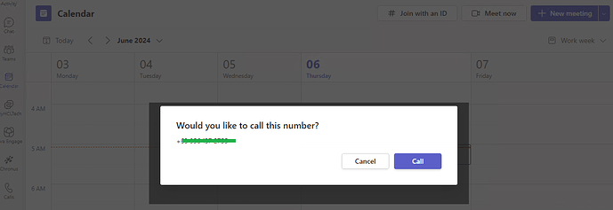

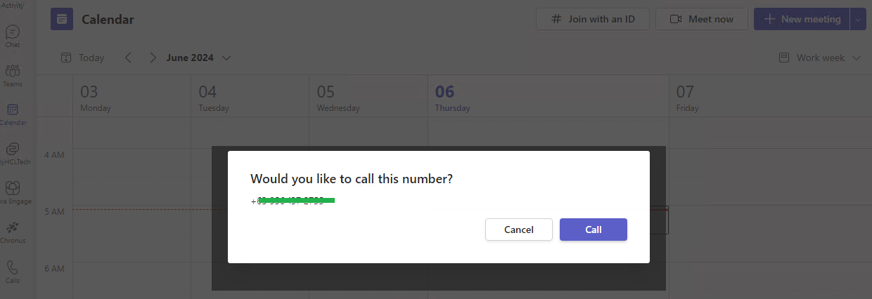

Hello Lutz,
I tried to reproduced your issue in Notes 12.0.2 FP3 (32-bit) standard client, and did not encounter the stated behavior.
First off, I used the below sample code in an Action button of a test Form in Notes:
Sub Click(Source As Button)
Dim uiws As New NotesUIWorkspace
Dim phonenumber As String
phonenumber = "<phone number>"
Call uiws.UrlOpen("tel:" & phonenumber)
End Sub
This the output (MS teams opened after I clicked the button in the Notes Form):
