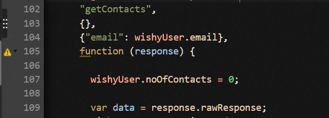

Hi there,I regularly get these sorts of linting warnings/issues in my code written in Volt MX. Is there any setting in the application to turn off/change those?

I found it. Actually, we can change the linting rules by going to Help -> JS Linting Configurations 🎉
Hi Vishal. I'm glad you found the setting. Just so you're aware, we have an article explaining how to change it:
https://support.hcltechsw.com/csm?id=kb_article&sysparm_article=KB0106894
