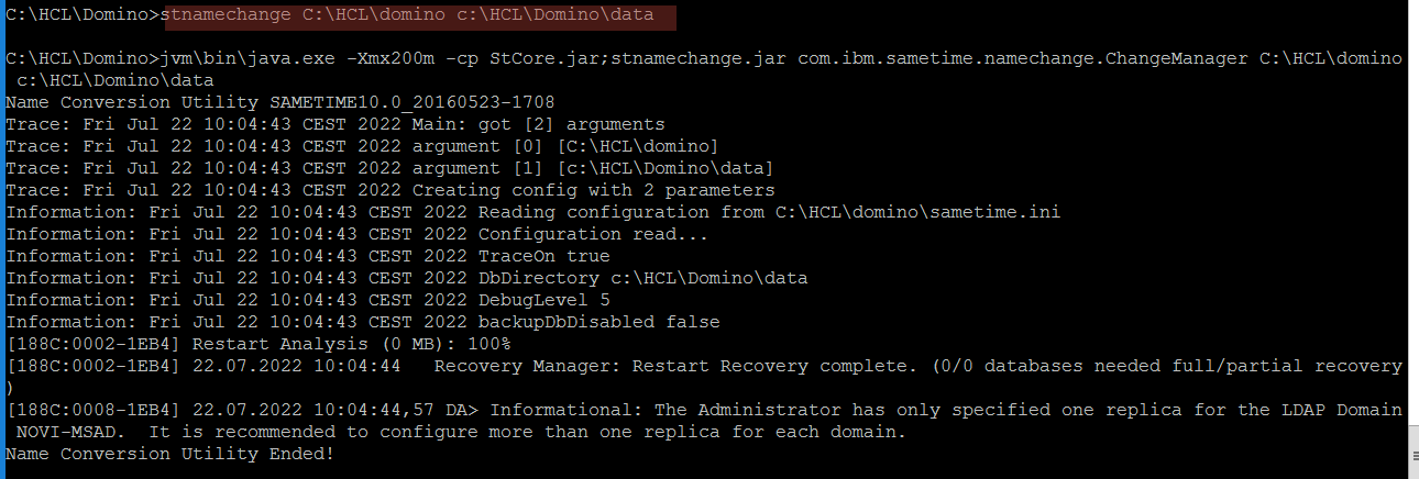

- stop your Domino Server > there is a change since Domino 11.0.1FP3 to start Domino process outside from Domino, but if the server is stopped you should be able to run the stnamechange in a command window
- change to domino program folder and enter the following parameter > please add domprog and domdata path otherwise it could be that the script will not find the correct paths
> stnamechange.cmd <domprogpath> <domdatapath)
e.g c:\hcl\domino>stnamechange c:\hcl\domino c:\hcl\domino\data

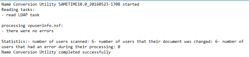

- Check <domprog>/Trace/name_change_summary_report_date.log
- For detail information check <domprog>/Trace/namechange_data.txt
- a backup of the old vpuserinfo.nsf (Notes Schema) is safed to <domdata>/vpuserinfoxxxxxx.nsf

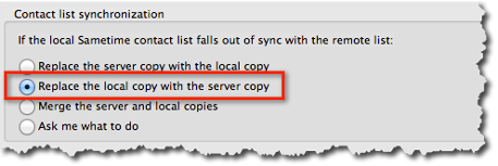

Please be aware that changes to the vpuserinfo or the buddylist will create a "conflict" popup at all sametime clients (contact list synchronization is set to "ask me what to do")
You can predefine the settings with these thre ecplise client parameters; this shoud be rolled out BEFORE the stnamechange
com.ibm.collaboration.realtime.imhub/buddyListConflictPref=replaceLocal
com.ibm.collaboration.realtime.imhub/showBuddyListConflictDialog=false
com.ibm.collaboration.realtime.imhub/showExternalModificationDialog=false

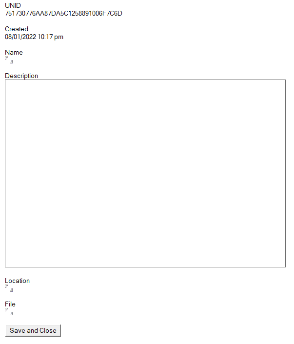

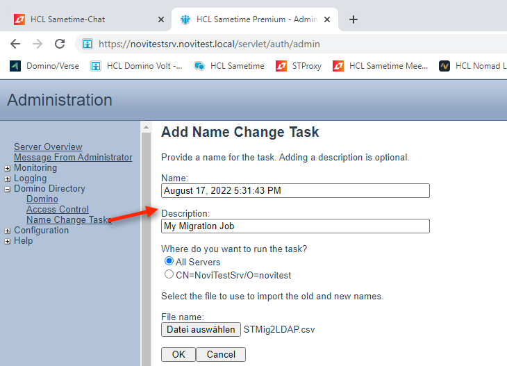

Could you elaborate on "- import the new csv file into stnamechange.nsf"?
How do I import this csv actually in this database? I can create a Notes form. Then I see this:
What should I enter where? I'm getting a big error screen when I run the command, so I'd like to know if I do something wrong.

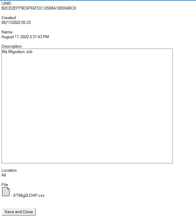

@Martijn de Jong i never tried this with a notes client - i used the webinterface from the sametime community server to import the files.

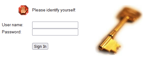

http://communityserver/servlet/auth/admin
If i open the document with my notesclient it looks like this - maybe this helps ?
Somehow for me it's simply not possible to get into the web interface. Your link goes to the stconfig.nsf database and the login prompt just returns without any message:
I can't figure out why this happens.
However, with your description of what's supposed to be in the Notes document, I could create the namechange through the Notes client and do the conversion. So thanks a lot!
be sure to use the cmd prompt in admin mode, if you want to perform the name conversion, make sure that the path in the variable is using double back slash
NSF path in the notes-migration-user-input.txt must be NSF_PATH=D:\\HCL\\Domino\\Data\\vpuserinfo.nsf
