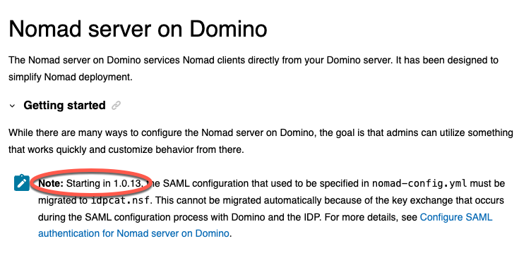

My next step was to follow the instructions in the documentation. As directed

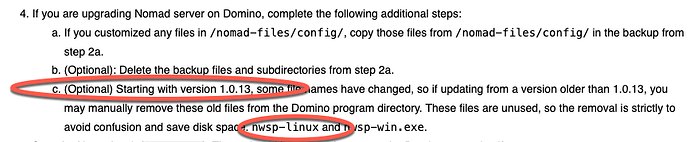

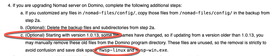

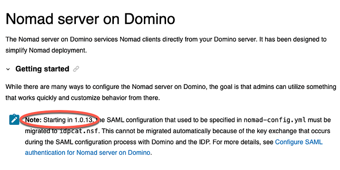

I made an appropriate back-up copy of my /nomad-files and proceeded to follow the instructions. I made special note of the two important changes for 1.0.13:
change 1:
change2:
This particular server is not using SAML, and doesn’t have a nomad-config.yml file, so that issue didn’t apply. Because I am a bit pedantic, I went ahead and deleted the nwsp-linux file as part of the update.

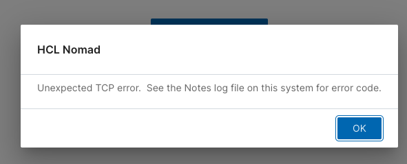

Everything seemed to be working fine. That is until I signed back into Nomad from a web browser and tried to open an NSF on the server.

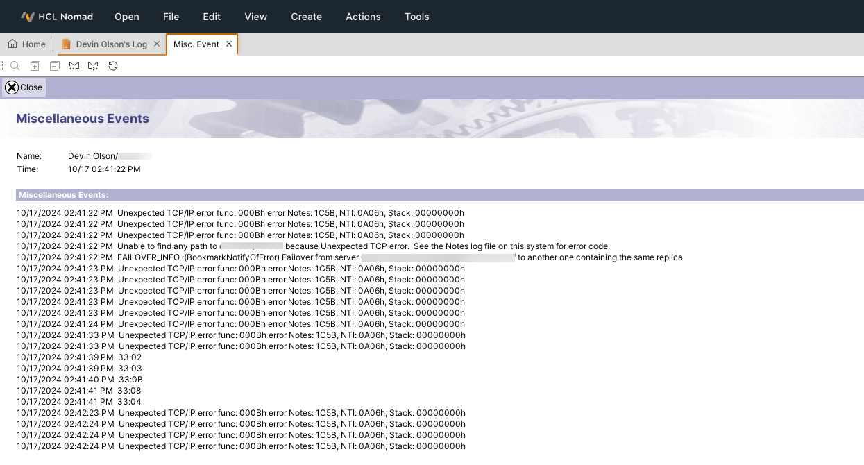

I was able to open my local notes log log.nsf within the Nomad environment, and checking the log revealed the following (server and organization intentionally redacted)
If you do (as did I) a web search for that error, you will learn it is related to a TCP/IP problem -specifically with IPV6 addresses.

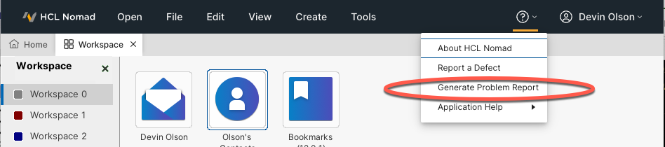

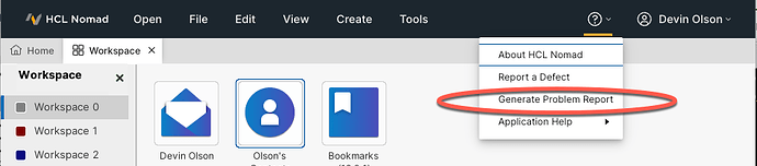

It was getting late, we were getting tired. Yao asked me to generate a Problem Report from Nomad and send it to him. This was functionality of which I was unaware, and let me tell you it is WAY FREAKING COOL!
He reviewed my report that evening, and did some testing on his development server.

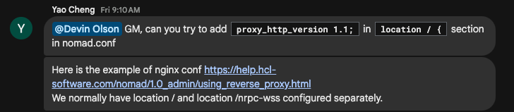

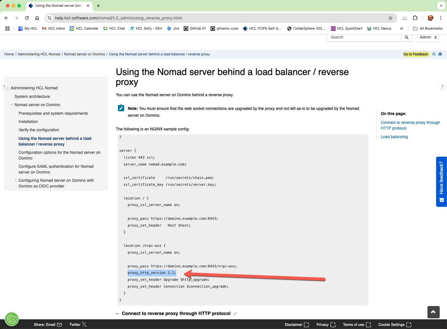

Then next morning Yao asked me to make a configuration change in my nginx configuration and test it out.
I did so, and it worked perfectly.
If you take a second look at that screenshot of our chat session, you will notice he also gently provided me with the URL to the Nomad documentation.
You know, the documentation I reviewed?
Well, in my “review”, I missed something extremely important.
Sigh. Boy did I ever feel like an idiot.
