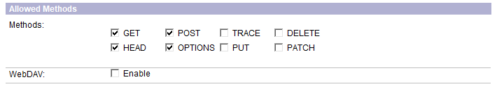

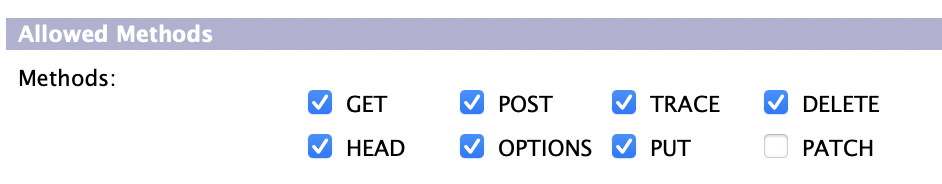

Have you checked the HTTP allowed methods in server doc or Internet site (according to your domino web configuration)
I think you need GET/POST/OPTIONS
Hello. I have these set up:
I guess it's good this way then?
Thanks.
