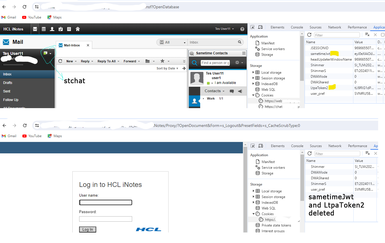

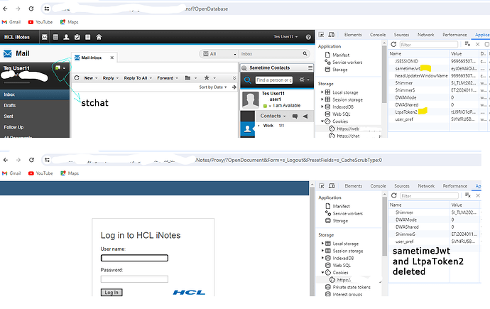

when i use iNotes webmail ( integration with sametime)
when i click inotes logout button, sametimeJwt token and LtpaToken2 are deleted, (both webmail and sametime chat are logout)

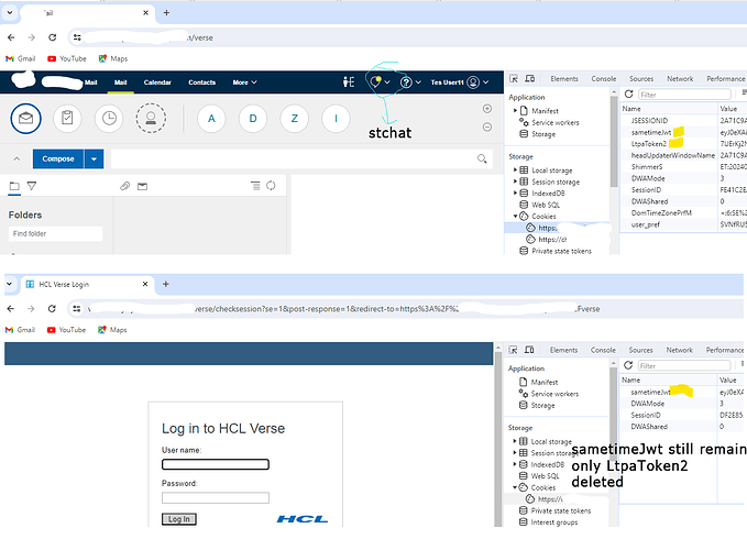

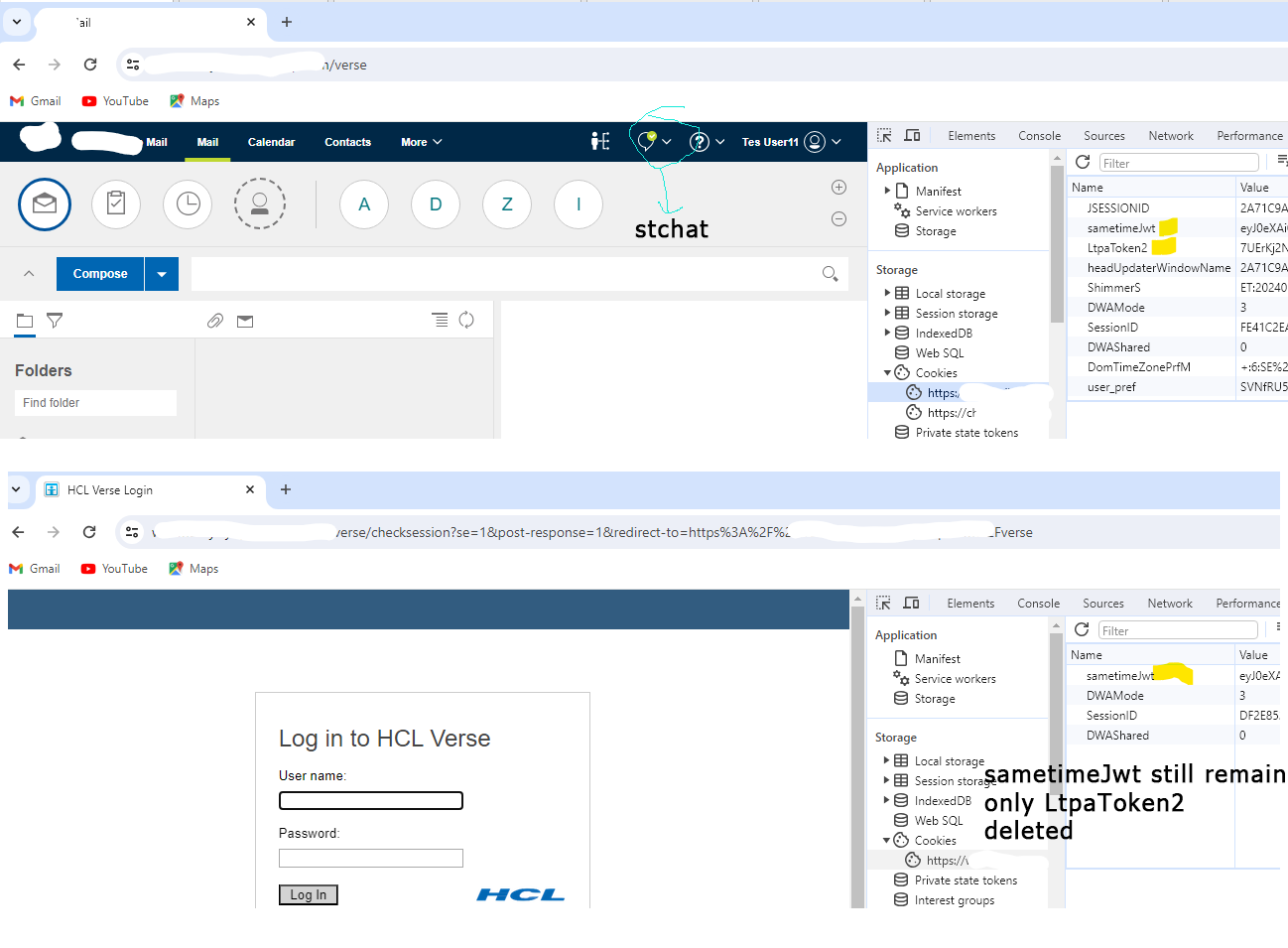

but, when i use Verse on Prem ( integration with sametime)
then i click Verse logout button, only LtpaToken2 is deleted, sametimeJwt token was not deleted
is there a way to configure verse logout button ?
