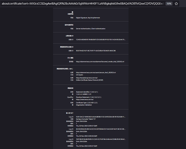

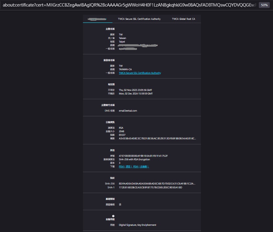

Checking keyfile certificates:

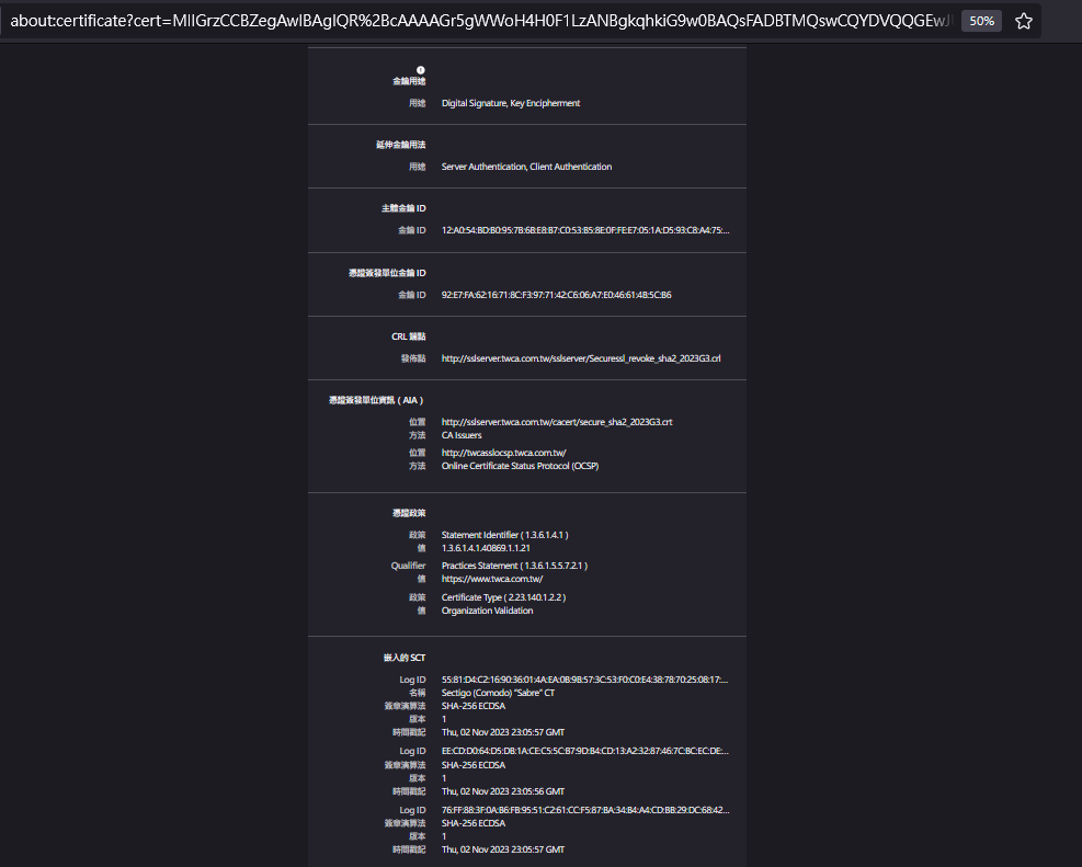

@Taiwan Jimmy Lu , have you check your ssl certificate? It must have extended "Server Authentication, Client Authentication", the "client authentication" is mandatory for starttls.
Yes, we have obtain a certificate for the client from a trusted CA ..

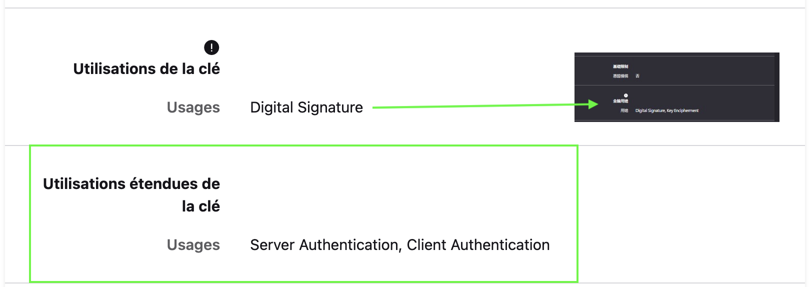

@Taiwan Jimmy Lu , just under your last section (the green arrow) check "Extended Key usage", you should have "Server authentication" AND "Client Authentication" (the green rectangle I do not have on you screen shot)
thank you for your response, the field have the value
