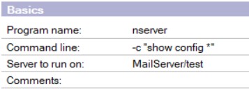

To do this, I create a program document with
nserver "-c show config *"
In the log.nsf I see the program start in console but no output.

The syntax of Program document seems to be incorrect.
It should be ideally nserver -c "Show config"

Hello @Juergen Thiel you need to correct the command line to get the output.

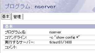

Hi @Juergen Thiel
You can execute the following setting in program document.
