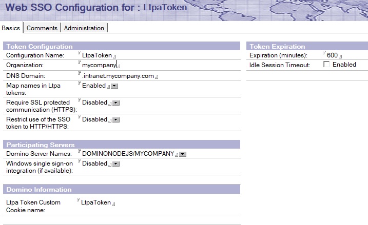

But I have not found anything that allows SSO between IAM and Domino authentication (LTP Token), example: a person authenticates in web access on Domino to access his mailbox then browses on a NodeJS application declared in IAM (same domain). Is there any way to prevent her from re-authenticating in IAM ?

it is not IAM that authenticates acces to Domino Web server but a classic web sso configuration

How should IAM know that you are still authenticated at Domino internal ? LTPA Token is normally not shared with IAM.

IAM does not support LTPA tokens.
We have items in our AHA list that request the integration of IAM with SAML or another OIDC provider like Azure. In this case, if both IAM and Domino were configured with a common IDP, they would share an SSO environment.
Domino does not currently support OIDC as an authentication mechanism. I do not know if there is an AHA item for this off of the top of my head, but in either case if you were to create one or vote it up it would help us make better decisions for what our userbase wants to see as future features.
