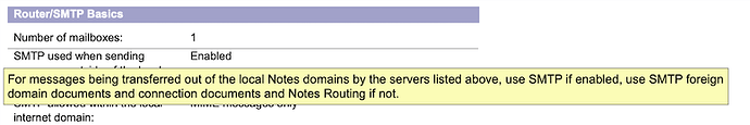

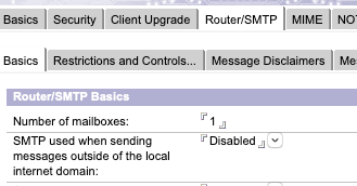

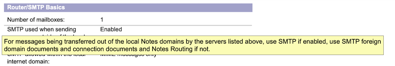

Hi Stephen,
please doublecheck the setting in the Configuration Settings document below Router/SMTP / Basics tab for that server:
SMTP used when sending messages outside the local Internet should be deactivated for that server. If this is set to activated for this server, it will send outbound mails directly to the internet
Only the (source) server that is configured in the SMTP connection document for your domain AllSMTP for sending outbound mails to the internet this SMTP used when sending messages outside the local Internet should be activated.
Anyway it is always a good idea to doublecheck the configuration is replicated to the server and appears at that server. And also send the tell router update config command via the domino console after changing settings.

Hi, Mike. the configuration is for the cluster, not the individual server. The other 3 servers route fine, just not the 4th server. I've updated the config after each change and also restarted the Domino server service repeatedly.

G'day! The document applies for the cluster and looks as follows for routing:
The config applies to the server group name, of which the recalcitrant server is a member.
Note that the address book replication is up to date. I have cleared the history and pushed replications multiple times. Server service and router have been restarted many times. The only thing I haven't done yet is make a new replica (or file copy) of the NAB.
Well, this gets even more strange.
By this setting all servers from the cluster should send the mails directly.
So, one acts correct (that you don't want) and any other send mails by error through the foreign domain documents (what you want)
So you are saying that should NOT be enabled.
