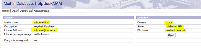

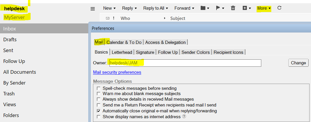

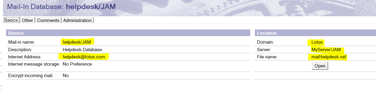

One workaround for your requirement is to setup a Mail-in Database on the Domino server to have separate email address for sending.
Using this database when the user send email to outside the email ID will look as below
You can refer the below document for "Creating a Mail-In Database document for a new database"
https://help.hcl-software.com/domino/10.0.1/admn_creatingamailindatabasedocumentforanewdatabase_t.html

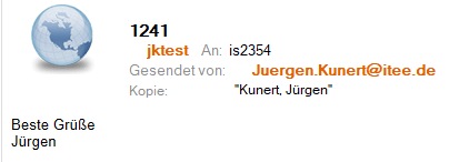

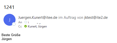

I am aware of that workaround. If you look at what the recipient will see, it is not distinct enough from the InternetAddress related to the Id used to create the mail.
This is what you see in the mail header:
ARC-Authentication-Results: i=1; mx.google.com;
spf=pass (google.com: domain of juergen.kunert@itee.de designates 85.xxxxx4 as permitted sender) smtp.mailfrom=Juergen.Kunert@itee.de
Return-Path: <Juergen.Kunert@itee.de>
Received: from xxxxm (xxxxm. [xxxx4])
by mx.google.com with ESMTPS id l23si1435451ejb.322.2020.06.30.03.41.29
for <is2354@gmail.com>
(version=TLS1_3 cipher=TLS_AES_256_GCM_SHA384 bits=256/256);
Tue, 30 Jun 2020 03:41:29 -0700 (PDT)
Received-SPF: pass (google.com: domain of juergen.kunert@itee.de designates xxxxxx as permitted sender) client-ip=xxxxxx4;
See some recipient screenshots:
