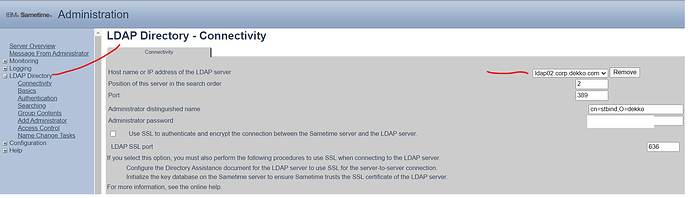

Searching for public name or public group returns: "The following search entry was not found or returned too many matches"

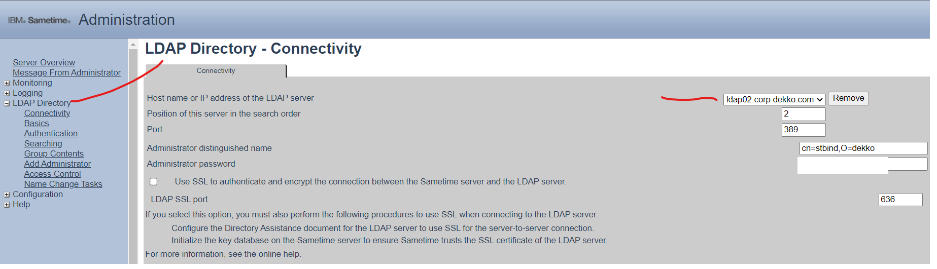

Searching for public name or public group returns: "The following search entry was not found or returned too many matches".
Some days it works, some days it doesn't.
@Robert Berendt are you using Domino directory, Domino Ldap or Active directory?
Domino ldap. LDAP02 is a Domino server.
On LDAP02 I am seeing the following in log.nsf:
05/30/2023 11:15:49 LDAP Server: Bind request for CN=Craig Strong,O=DEKKO failed: Invalid credentials specified: failed to authenticate
IDK if that's this issue with Sametime or other LDAP requests. I would have thought that "Administrator distinguished name" provided on the screen above would be the connecting factor for Sametime into ldap.
ldap02 is running Domino 12.0.2 on IBM i 7.5 on Power 9 hardware.
Sametime is ancient. Sametime 9 on Domino 9.0.1FP3 on older versions of Windows server.
