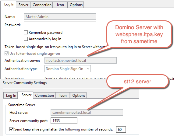

I installed a new st12 environment (docker/podman) with chat only.
Sametime SSO is configured via an existing domino server
(SSO server = domino host; sametime server is a different host).
This is working for Notes rich clients, because i can enter a different authentication server for my ltpa login.

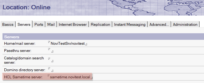

But for the Notes basic client i do not have any options; i can only set the sametime server within the location document
Is there a way to set the authentication server for basic client as well ?

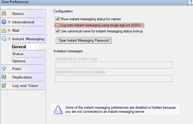

Hello Casey,
yes there is an option within notes basic client to support ltpa sso login to sametime and this is working until sametime 11.6 server.
There is also an INI parameter IM_ENABLE_SSO=1 to set this value.
But i cant find a parameter to define a different SSO host other than the st server (now needed with st12).
