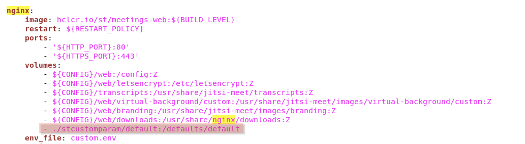

  1. copy nginx default configuration from nginx container to custom path
    > docker cp st12-nginx-1:/defaults/default stcustomparam/

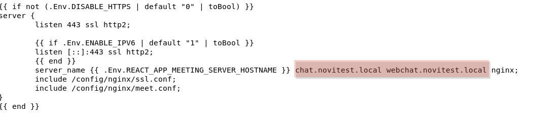

  2. change the default file and add my additional hosts, i leave the environment variable REACT_APP_MEETING_SERVER_HOSTNAME inside (variable will read from the docker .env)
  3. add my custom default file to the docker-compose.yml
  4. If i check the nginx configuration within running nginx container i will see all my hostentries
    > docker exec -it st12-nginx-1 cat /config/nginx/site-confs/default
  5. Now i can access with all my hostnames

Maybe there is a easier configuration, because the nginx-container:/defaults/default file already has variables within
> server_name {{ .Env.REACT_APP_MEETING_SERVER_HOSTNAME }} {{ .Env.REACT_APP_CHAT_SERVER_HOSTNAME | default "" }} {{ .Env.EXTRA_VHOSTS | default "" }};
coming from the .env docker config-file, but setting the parameter within .env does not change anything inside the nginx container.

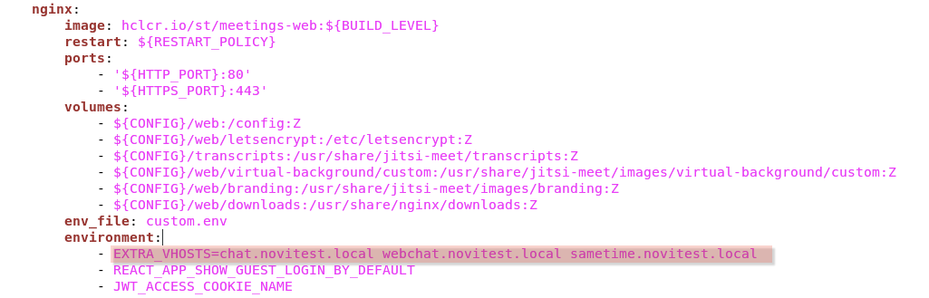

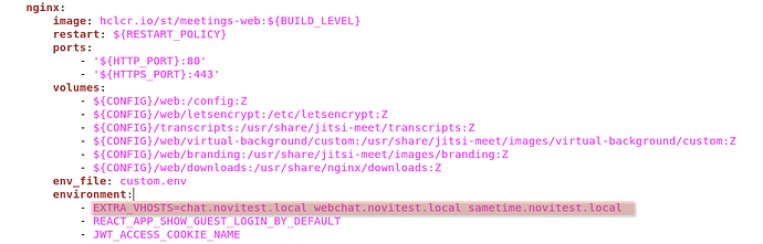

Update
If i add the parameters directly in the docker-compose.yml file in the section nginx this will work also and it is much easier.
