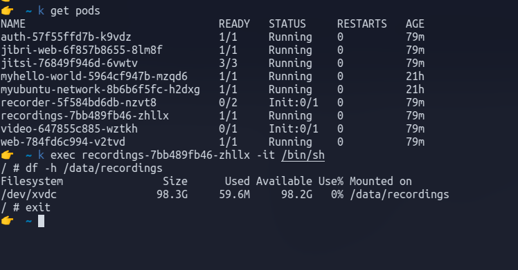

Hi, Anthony
See the container recordings using the 100GB volume.
The video / recorder containers also need a volume, because I haven't found them in the helm chart yaml.
I would like to better understand this prosody check, which is preventing containers from starting.
