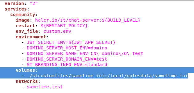

If you need to modify more sametime.ini parameters you could export the sametime.ini from within the running container to the local file system (e.g. create subfolder within sametime installation folder stcustomfiles)
> docker cp st12_community_1:/local/notesdata/sametime.ini stcustomfiles/sametime.ini
You could check files within running docker container
> docker exec -it st12_community_1 /bin/bash
> ls /local/notesdata -l
Change your settings within the stcustomparam/sametime.ini file and add the following parameter to the docker-compose.yaml file to load your local sametime.ini upon docker start
> services:
community:
volumes:
- ./stcustomfiles/sametime.ini:/local/notesdata/sametime.ini
networks:
There are more sametime community files you maybe need to export and implement (e.g. policies.user.xml, UserInfoConfig.xml)

You could also (as i prefer as more flexible) export the sametime.ini to your filesystem and use this sametime.ini file on docker start. See my first entry for the parameters
Add the files to your docker-compose.yml
