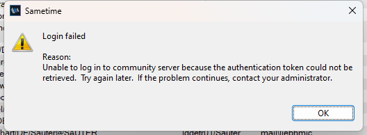

When I use the Sametime embedded client in my Notes 12.0.2 Client I cannot login. The error message is:

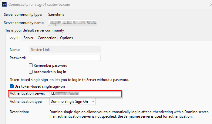

As soon as I enter an authentication server in the community settings, it immediately works
We used Sametime 11 before and it worked without this entry for all of the 2.500 users...
Do I have to populate this setting with the mail- home- server for all the users before switching to the new server or is there a way to get Sametime 12.0.1 to work same as Sametime 11 without this?
Hello.
The authentication server specifies the Domino server that issues the LtpaToken.
Previous releases had a Domino server as the base for Sametime Server.
If the Domino server with Sametime providing the LtpaToken, there was no need to enter anything in the Authentication Server.
With Sametime 12, the authentication server (LDAP) and the Sametime server are different. Setting the authentication server is required.
Rich client settings may be distributed by managed-settings.xml.
https://help.hcltechsw.com/sametime/9.0.1/config/config_client_comm_pref.html

Ok, that explains it. I thought, that it was the Mail- Homeserver that was taken, if no entry was in the field.
The company has locations with servers all over the world. The old Sametime server was (and still is) reachable from every location... Now without the domino based Sametime server there is no more universally reachable Domino server for all users. How do I use managed-settings.xml to assign individual Token Servers to individual locations?
And: What are the requirements for a server to be able to deliver the token? Yesterday I tested 4 servers in 2 different clusters. I could login using two of the servers as Authentication servers but not with the other 2 although the cluster partners are configured identically (same LTPAToken, same Domain, etc...). To be clear: I could login with the first server in the German Cluster, but not the second. And I could login with the second server in the Suisse Cluster, but not the first...
