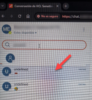

Sametime 12.0.1 + Domino 12.0.2 (LDAP server) problems usernames list
New Sametime 12.0.1 instalation on Docker (sametime + MongoDB on the same server), and Domino 12.0.2 for LDAP server on a second server.

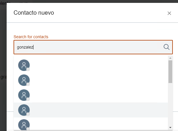

After install ... users has problemas to access to sametime list, if seach for a name, results empty names or undefined (in Notes Sametime embebed + Sametime web client).
Any idea ¿?
thanks
Hi Frederico,
It would be best to open a case with us, there are too few details.
Most of the time Domino LDAP works with Sametime without customizing settings. If you are able to login, then Sametime is connecting to LDAP, but there are several places to configure LDAP. There are extra steps if you are using a secure LDAP connection, also Domino 12 does not have the cipher suite Sametime needs enabled by default.
It would be easiest to start by checking the logs for community and proxy. Instructions here: https://help.hcltechsw.com/sametime/1201/admin/troubleshooting_docker_logs.html
You can also try enabling some debug.
https://help.hcltechsw.com/sametime/1201/admin/troubleshooting_debug_trace_docker.html
The logs will tell us what might be wrong. Let us know if you need help, you can open a case with us.
