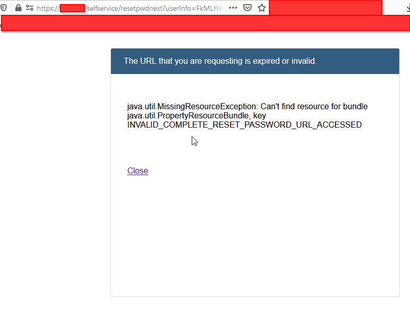

Hi,
After upgrade to Connections 7 the guests users are receiving invalid password reset link. Any ideas?

Hi Pratyush,
have a look at CS0183555, the reset password was broken in 7.0 Invite, not sure if the fix is contained in CFIX 7.2105, but I think there was an update available.

Hi,
As I said Invite and Registration are OK. Only the password reset is not working no matter the browser
No, the KB article is different and this is resolved. Same ticket describes the rollback to 6.5 jar, because of a password reset issue.
So I assume this is not fixed in 7.0 and not tested from my side in CFix 7.0.2105, will do that soon. As far as I can remember it is a type conversion issue and the calculated time is always wrong so the reset does not work.

Have you installed the Cfix 7.0.2105? I tested and can reset passwords after installing the CFix.
I can confirm this. Reset guest password was broken with 7.0, but is now fixed with CFix.70.2105.
