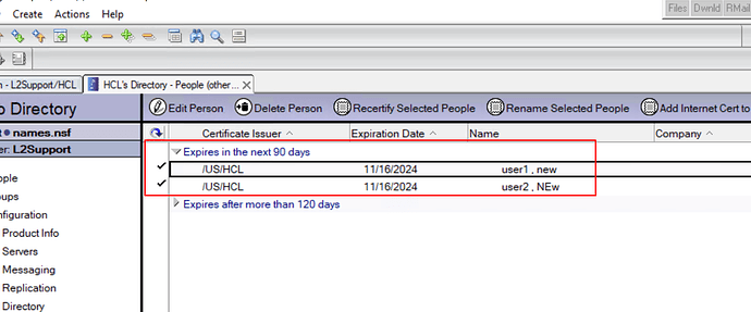

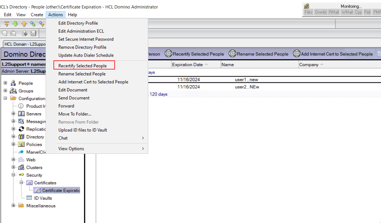

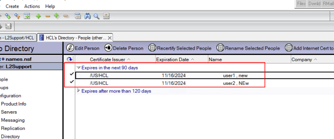

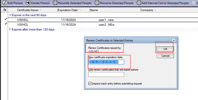

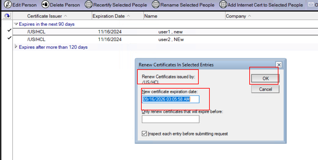

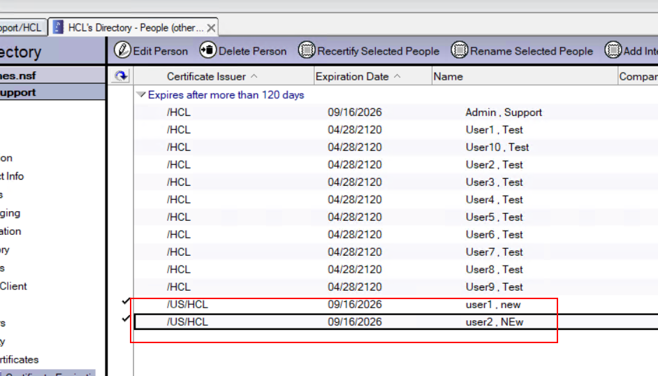

Hi Jan,
Good Day
Hope you are doing well.
To recertify user setup with "organization/01", You will have to use the Same Cert ID.
For example, If "New user01" is setup with "US/HCL" Organization unit (New User01/US/HCL), then to recertify the "New user01", you need to use same Organization unit (US/HCL). you can not use "/HCL" Organization ID.
To recertify user, you can proceed with the address book in view "Certificate Expiration" with use "Recertificate selected people.
Once done let the Adminp process execute the request.

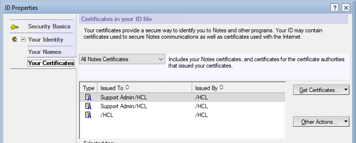

Dear Christian, i checked both ID and properties. Username is still same, but as you can the Issuer was chenged and this is mysterious.
Year 2009- Name of User John Doe/US/ACME
Issued To Issued By
John Doe/US/ACME /US/ACME
/US/ACME /ACME
ACME /ACME
Year 2011- Name of User John Doe/US/ACME
Issued To Issued By
John Doe/US/ACME /ACME
ACME /ACME
Many thanks for help,
JP
