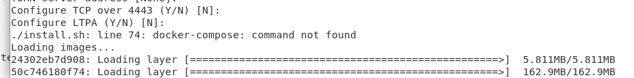

I am receiving an error when running the script.
and
Did you follow step 2 in this link?
https://help.hcltechsw.com/sametime/12/admin/installing_docker.html
Did you install the separate docker-compose command as described in the Sametime product documentation?
