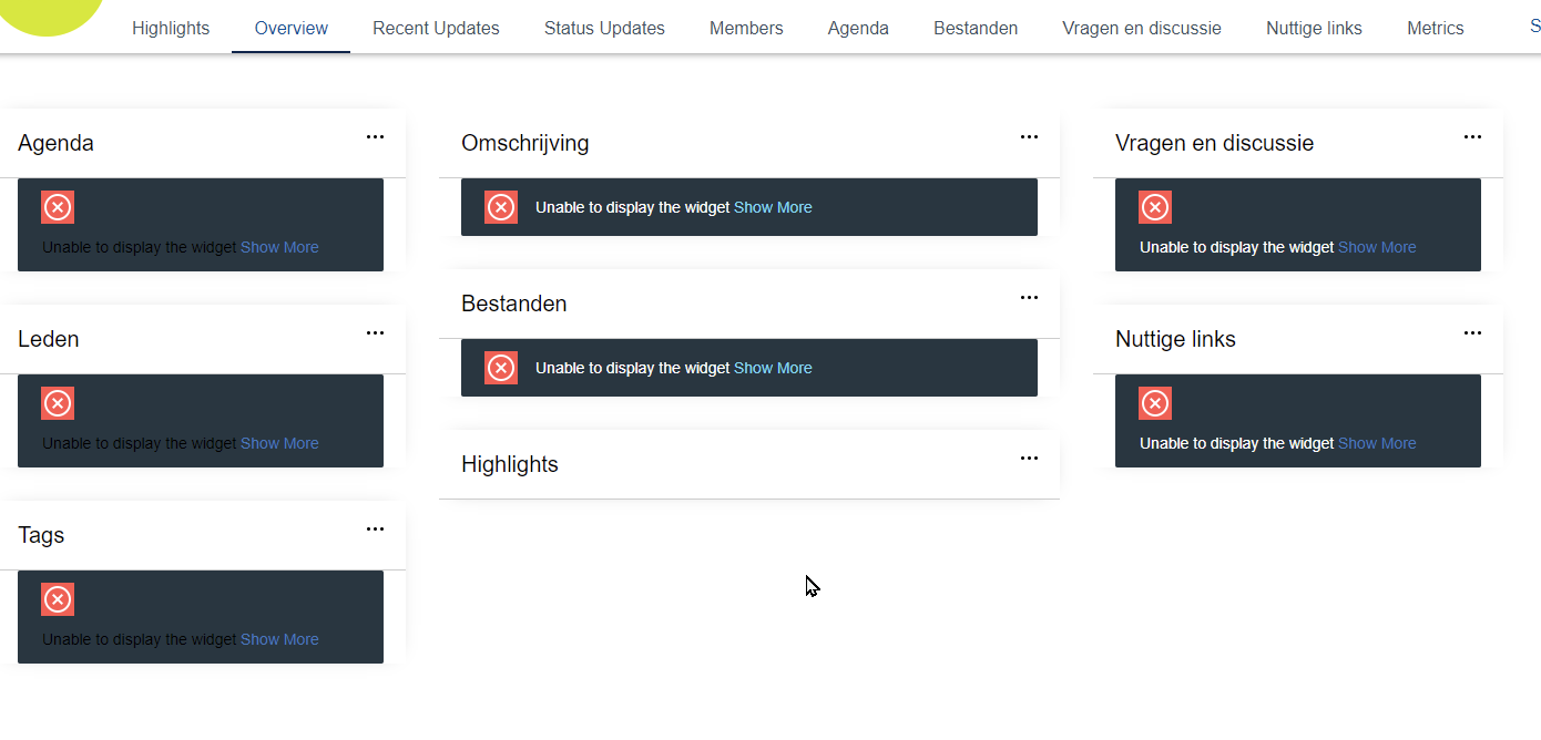

Now I can log into Connections through keycloak. The homepage is working as are files and forums etc. However, communities are looking like this:
The accompanying error looks like this:
[14/01/24 21:57:55:120 CET] 00000239 SRTServletRes W com.ibm.ws.webcontainer.srt.SRTServletResponse addHeader SRVE8094W: WARNING: Cannot set header. Response already committed.
[14/01/24 21:57:55:122 CET] 00000239 LotusConnecti E An unexpected exception was caught by HCL Connections. The error page generated for this exception will display the identifier below.
[14/01/24 21:57:55:122 CET] 00000239 LotusConnecti E Identifier: LC97610361DB044CCEB6F9BBD93C5E6284
[14/01/24 21:57:55:123 CET] 00000239 LotusConnecti E User-Agent: CRE
[14/01/24 21:57:55:123 CET] 00000239 LotusConnecti E Request URI: GET https://athena.martdj.nl/connections/resources/web/lconn.comm/communityMembers/communityMembers.xml
[14/01/24 21:57:55:124 CET] 00000239 LotusConnecti E Remote user: null
[14/01/24 21:57:55:124 CET] 00000239 LotusConnecti E Locale: en_GB
[14/01/24 21:57:55:125 CET] 00000239 LotusConnecti E Session ID: SIc6TKDIJ54U8cIGgxe1mAA
[14/01/24 21:57:55:125 CET] 00000239 LotusConnecti E An unexpected exception was caught by HCL Connections. The error page generated for this exception will display the identifier below.
java.lang.IllegalStateException: SRVE0209E: Writer already obtained
Hi Martijn
this happens due the
com.ibm.websphere.security.performTAIForUnprotectedURI=true
setting. Setting this to false or remove it should fix the problem.
At the end, all communities should work, except the ones that use the rich content widget.
Communities with it will either show an error in the widget or just reload.
browser console shows an error 401 for the request.
