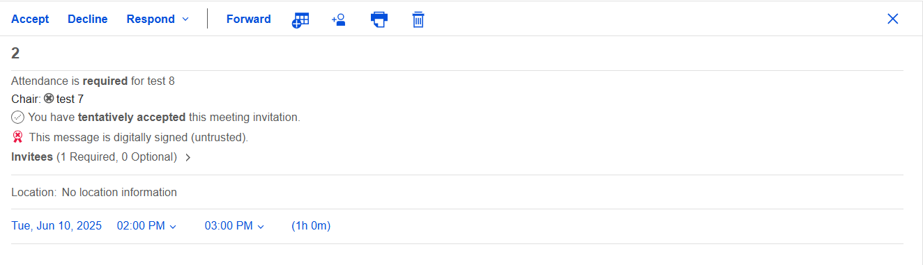

We are facing a problem with digital signature violation in meeting invitations:
  1. If a user accepts or declines an invitation, the signature is lost
  2. If the user delegates or tentatively accepts the meeting, the signature is broken, for example:
Is this a bug? Why does this happen with digital signatures?

Try to create an invitation in Verse and digitally sign it. When the meeting participant receives this invitation, for example tentatively accept it. You will see that the signature from the meeting participant will be broken in that meeting

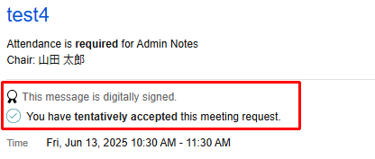

I tested again, but I cannot reproduce the issue in my environment. Here is a screenshot from my environment.
The signature has not been corrupted. At this point, I don’t know the cause. I think it would be better to open a case.

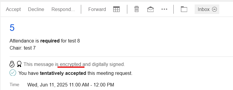

We have tested your option with encryption and digital signature and we have the same unbroken signature:
Try only signing the invitation and you will see the problem
Thank you

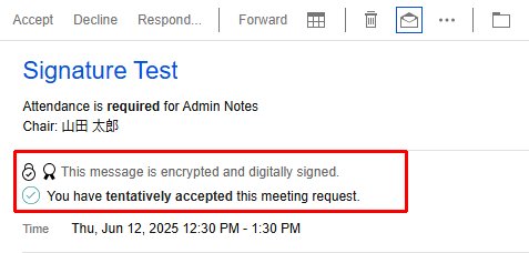

Hello.
If you check encryption as well, will that not cause problems? It’s a strange behavior..
I tested to send a meeting with signature only. Here is a results.
