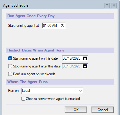

Agent manager is actually working as designed here. If we don’t want to have that agent run again on the same day it was changed we can alter the schedule so that it does not get scheduled to run until the next day. We can do this by changing the “Start running this agent on this Date” to be the next day.
Hopefully this gets you what you want.
