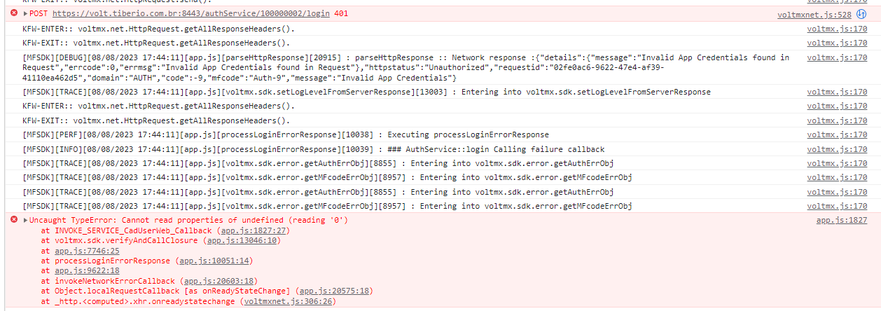

All APIs are publicly accessible. Below is a more complete print of the error.
The url on the first line, I don't know why the system is requesting authentication, I don't have anything configured for that and it was working before. I don't understand what changed.
