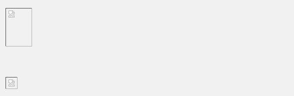

If you had the case that the photos of the wikis were inserted were suddenly no longer displayed. A browser cache problem is not. If I want to edit the wiki, the photos will only be displayed as in the screenshot.

I see this sometimes with Ephox / Tiny Editors and images pasted through copy & paste. During paste an wiki attachment should be generated, but this does not happen. So when you check the attachment area of the page, are the images present?
Only a few or always? During normal work or after update?
In an old CR I've seen this with enabled whitelists.
We updated from CR4 to CR5 but long time ago. Only a few wikis are affected.
We have no custom whitelist in the ojhs-whitelist-default.xml file.
You're right. The attachments under the wikis do not contain any photos. Then we need to upload them again. Thought there was a workaround. :-)
