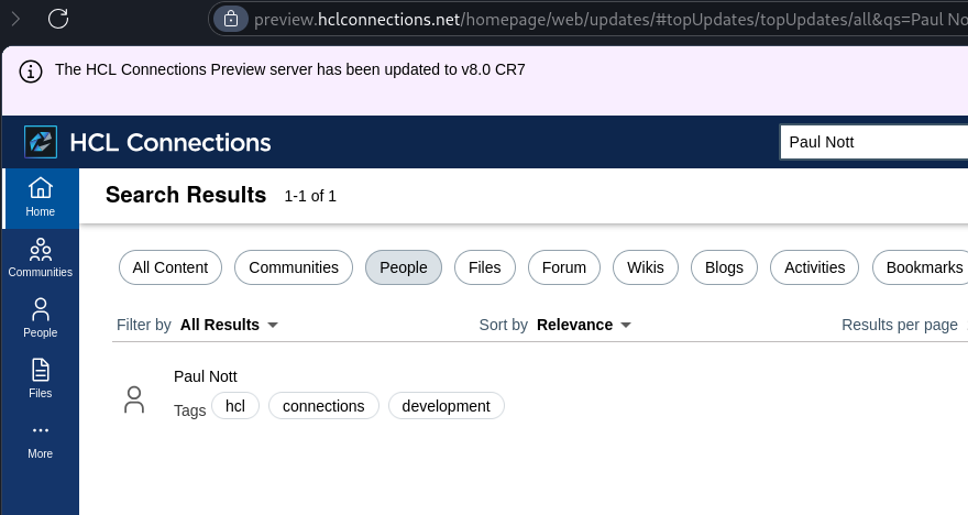

seems like a bug, I can reproduce in CR7 on the preview server:
https://preview.hclconnections.net/homepage/web/updates/#topUpdates/topUpdates/all&qs=Paul%20Nott&scope=profiles&ntf=false&p=1&ps=10&soc=%7B%7D&sk=relevance&pers=false&communityUuid=undefined&wikiLabel=undefined&ppl=&t=&dr=&do=all&sc=
When I search for Paul Nott (who has a profile picture), I get this result:
Or you search for Michael in People, you get more than 10 records with default SVG.
Petr when you have opened a case, please send me the number, so I can create one too and connect them.
But could also be a feature:
It looks like the search view shows the default icon of the application and not the profile / community image.

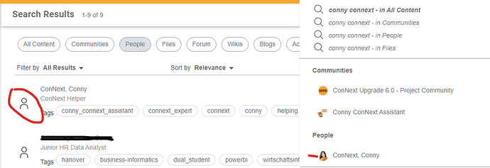

yes, it looks like a bug, we have the same issue on 3 instances and on an older Release v8.0.0.0 Build IC8.0_CR2_Integration_20230416-1915 we can see the pictures as expected.
however, since at least CR5 we only see this
even the quick results deliver a picture:
I will open a CASE for that and let you know.
