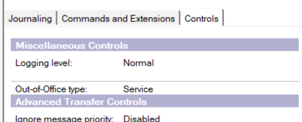

Be sure that the mail template is not at a higher level than the server version. If the user’s template is higher than 12, then bring it back to 12. There are probably other issues, but this is a good start. Also check the config doc for the server. Is the Out-of-Office type set to “Service”? You can find this on “Router/SMTP” > “Advanced…” > Controls

Did you check the following “check the config doc for the server. Is the Out-of-Office type set to “Service”? You can find this on “Router/SMTP” > “Advanced…” > Controls”
Hello, tchildy
Yes, installed
