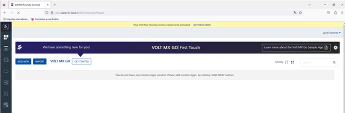

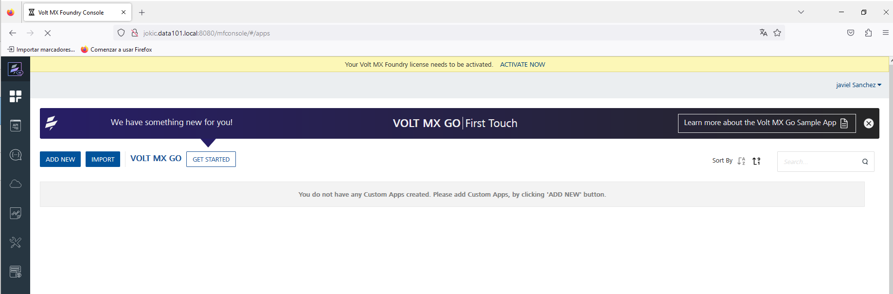

sure!
That's the console url working

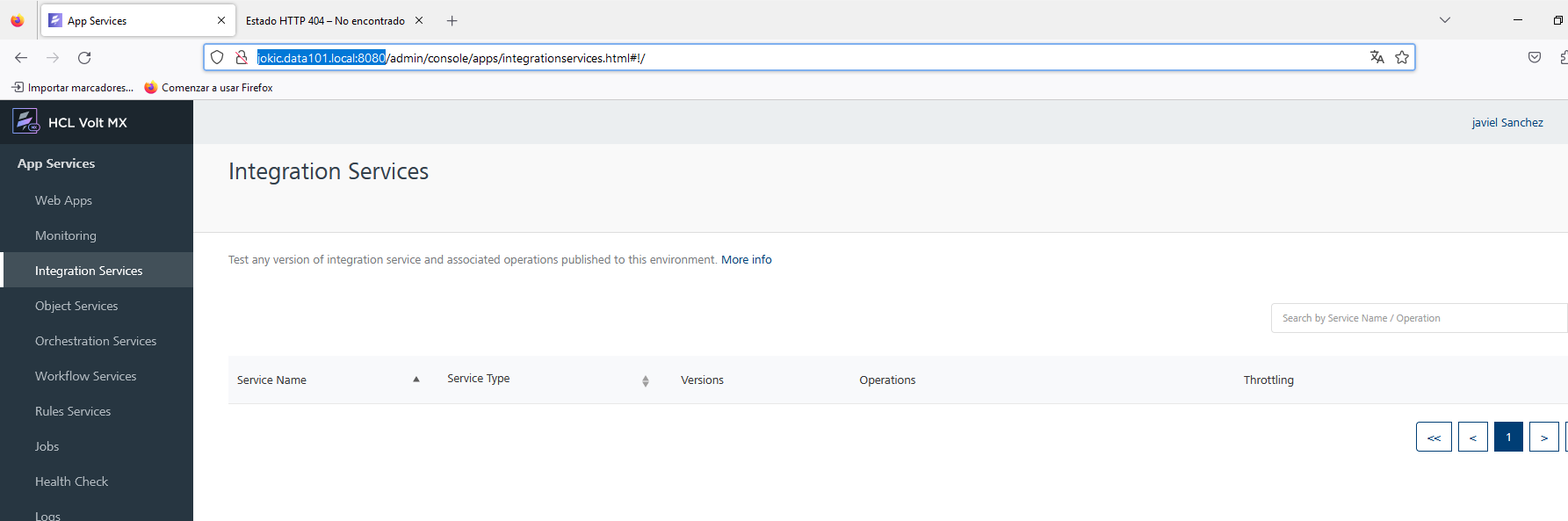

Here is the Admin url

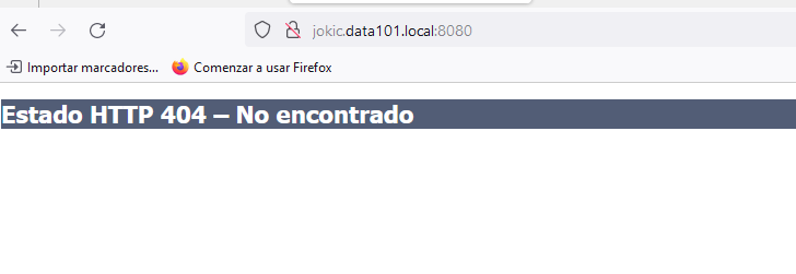

That's my root url:

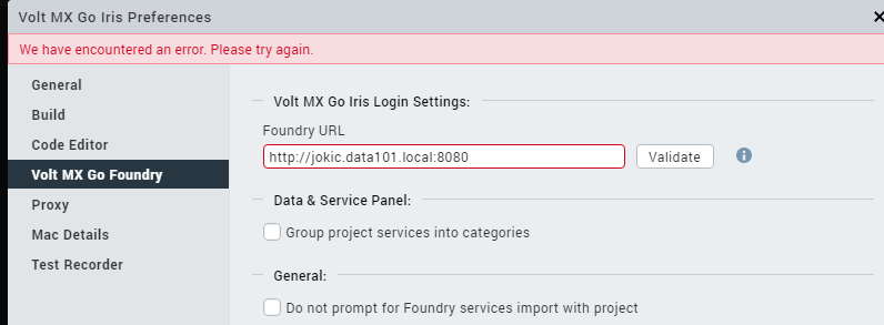

And the Iris error:
Hi Javier,

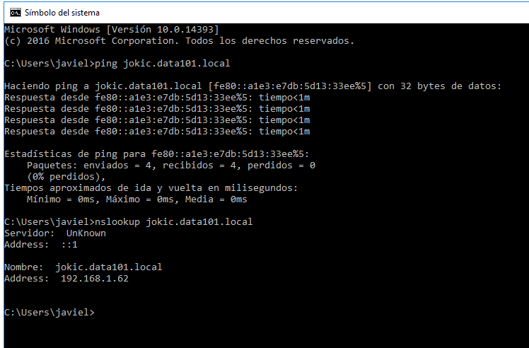

Can you confirm that the domain name "jokic.data101.local" is reachable by your PC host (the PC running Volt Iris)? If you are using Mac, open "terminal"; if you are using Windows, open a cmd window.
Can you "ping jokic.data101.local" ?
Can you "nslookup jokic.data101.local" ?
Yes, all the screenshots were taken from the same machine, the one in wich Foundry and Iris are installed.

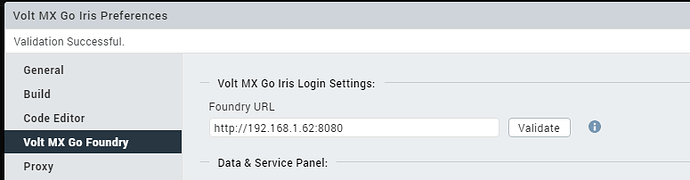

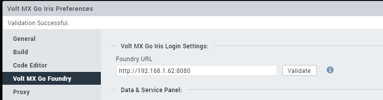

Please try setting your Foundry URL in Volt Iris' Settings using the IP address; for you that Foundry URL should be
http://192.168.1.62:8080/
Also, run netstat command to make sure Foundry is "listening" at port 8080. Run this in your cmd window:
netstat -a | find "LISTEN"
You should see the port number 8080 showing it's listening.
That works!

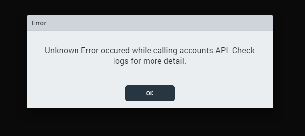

But when I try to log in....
We're one step closer :)
Where I can find those logs? are there Iris logs or Foundry logs?
