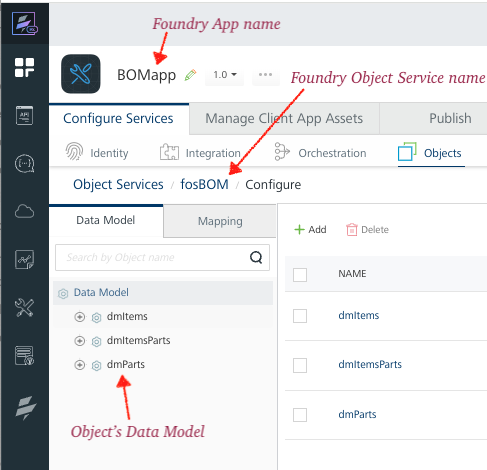

Hi Suresh,
Is "report_health_issues" your Volt Foundry's Object Service's "Data Model" name?
Below is an example snapshot of my Volt Foundry Object and data models. "dmParts" is a data model and should be the target of the code line: var recordObj = new voltmx.sdk.VMXObj("dmParts");
