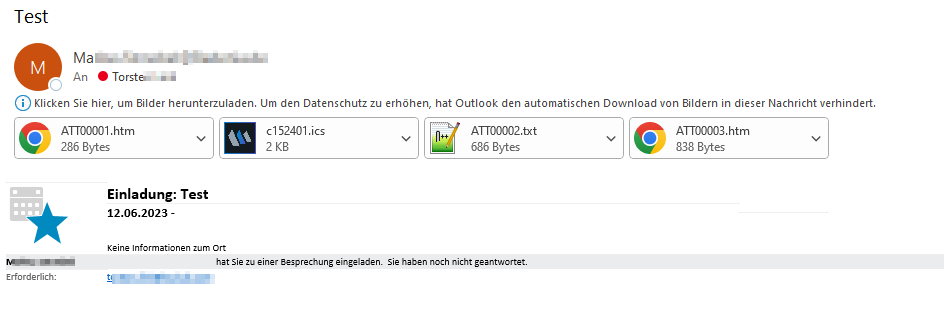

Whenever the users send mails to any O365 recipient one of two things happen: If the checkbox "Some invitees use other mail programs" is not checked, then the invitation shows in Outlook as "normal mail": It cannot be accepted nor declined and does not look like an invitation at all, but it contains an ics file attachment that can be opened:

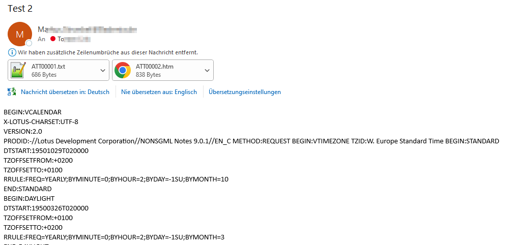

If the checkbox "Some invitees use other mail programs" is checked, then the ics file arrives as text file within the body of the mail:

First off, that iCalendar in Test 2 was generated by a Notes 9.01 client and not a 12.02 Domino server. You can tell by the PRODID value ("9.0.1//EN_C"). That means the INI you set is not likely to have any effect since Domino is not generating the MIME message, Notes is (at least for Test 2)
The odd formatting of the iCalendar in Test 2 is a minor concern since each iCalendar property should start on a new line, not be appended to other properties. I suspect that is likely just a rendering artifact since I do not recall ever hearing a customer report about bad iCalendar like that in 9.x.
The .ics attachment in Test 1 is an ancient legacy artifact from the transition period where iCalendar support was not yet implemented by some vendors (~ Domino 6.0). We attached a copy of the iCalendar portion of the message so that recipients on systems that did not grok the RFC 2447 messages could open it with a client that did understand iCalendar.
Looking at Test 1, it looks like O365 is rendering the text/html body part with the rich rendering of the workflow message. From the available info I cannot who generated the MIME message (Notes or Domino) or why O365 would only render the text/html body part and not the iCalendar. If the issue were with the iCalendar itself you would see an attachment like this:
