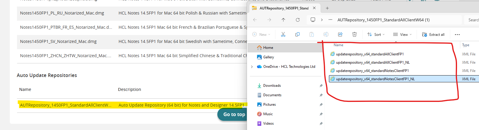

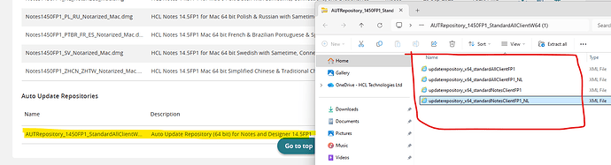

As informed, we have collaborated with our development team, and they have taken the necessary actions to correct the previously uploaded incorrect “All Client” XML file and to upload the “Standard Client” XML file as well.
Below screenshot for your reference:
I hope this addresses your query posted on the forum.
