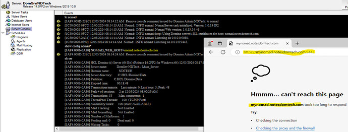

Nomad server not listening?
Setting up my first Nomad server (1.0.13) on Domino 12.0.2 FP2 (Windows 64)
I have configured manual TLS Certificate.

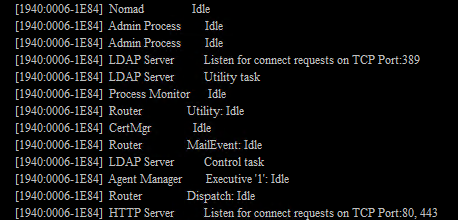

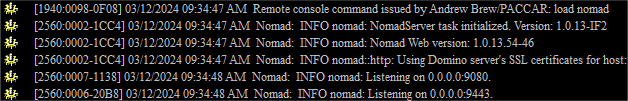

When I load Nomad at the console it shows:
So far, so good. But when I show tasks, Nomad shows as idle, although other tasks show themselves as listening on the appropriate ports.

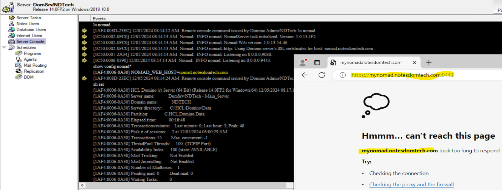

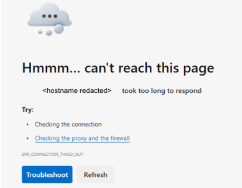

When I browse (using Edge) to <hostname>:9443, hoping for a Nomad setup screen, I get the response:
Is there a vital step I am leaving out?

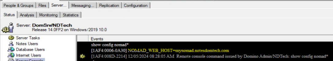

Nomad should indicate that the http and/or https servers are running, the port numbers, and the bound host. Also, make sure that the pre requisites are met (ID files in ID Vault, TLS cert) and to open the notes.ini file of the Domino server and add the below notes.ini setting to have the Nomad server host name.
Nomad_Web_Host= <hostname>

You can run "netstat -qo" command from a command prompt to see if 9443 is Listen.
I suspect that port 9443 is not available in your environment.

Port 9443 has been opened in the firewall, and I have confirmed via Powershell that it is accessible, but I still get the same timeout.

What is the full URL you are using? Do you have the /nomad/ on the end?
The full URL is as I quoted above. I have tried with /nomad/ at the end, with the same result.
Simply using the hostname, without specifying a port, immediately gets me the default Domino splash screen.

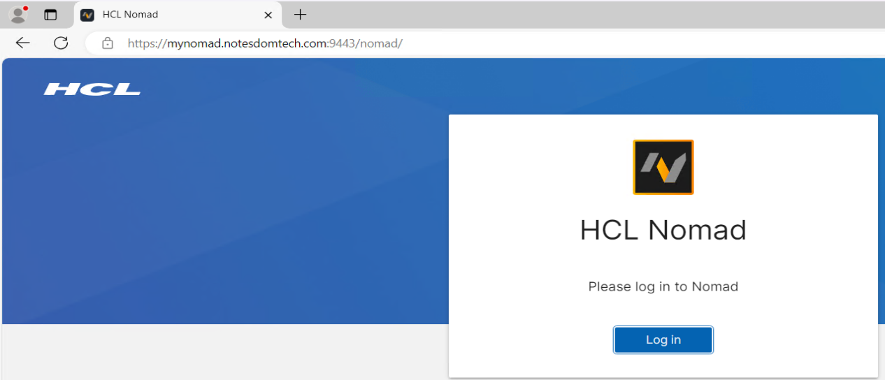

I don't see where the full URL is above. I see "<hostname>:9443" but that isn't a full URL. You at least answered the /nomad/ part on the end, but do you have https:// on the beginning? If not, it will be HTTP and port 9443 isn't listening for HTTP.
Leaving off the port will be HTTP or HTTPS depending on what you have at the beginning (or nothing which is http:// by default and port 80).
It needs to be https://<fully qualified host name>:9443/nomad/.
After that, it really seems like something in the firewall or a browser setting that is blocking it. You could temporarily put Nomad server on port 443 (and turn off Domino HTTP on port 443) and see if that makes it work because if that works, it probably is some rule/proxy/firewall somewhere blocking it.
Did you try any other browsers (Chrome or Firefox)?
You can also try https://<fully qualified host name>:9443/nomad/userConfig.json which should be a JSON response and doesn't require the service worker or any part of the Nomad for web browsers client to be downloaded to run (it is just a regular HTTPS request and response).

When I specify https (I thought that port 9443 would redirect to that automatically) I DO get Nomad, but only after it gives me a security warning.

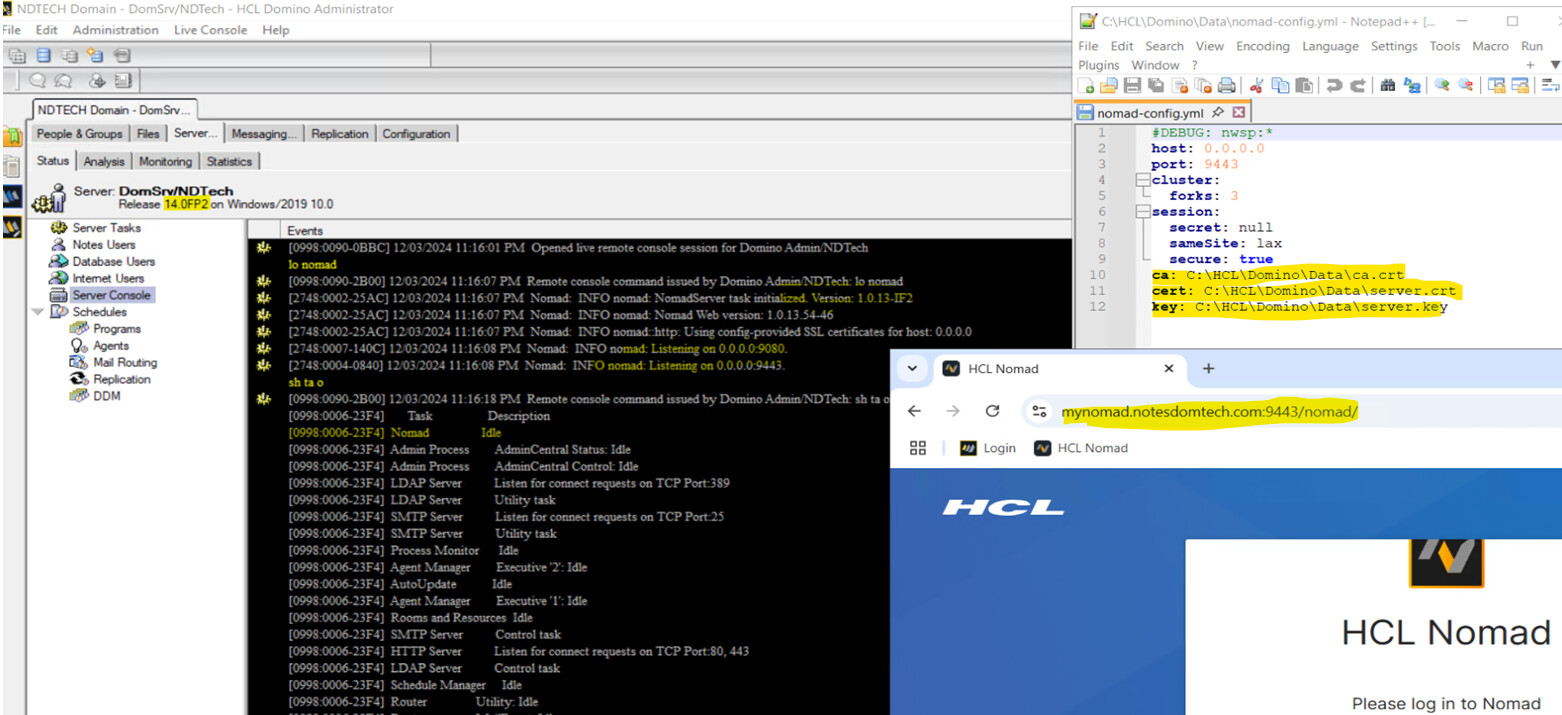

Hi Andrew,
I can see the same issue as yours as below.

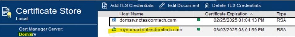

I believe you are using the certmgr task (certstore.nsf) on the Domino server to use the TLS certificate for your nomad server.
Please verify the following:
1) What is set in the Domino server notes.ini parameter for Nomad_Web_Host ?
2) Is it the above value set same as your Nomad server host which you are trying to access it from the browser ?

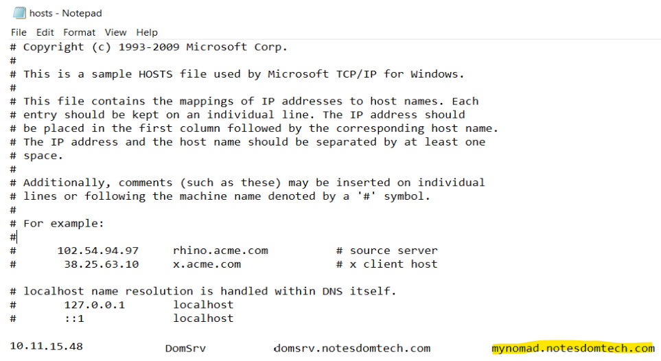

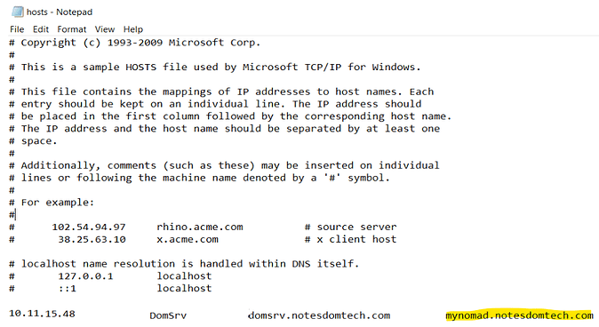

3) Do you have DNS entry or local host entry for the Nomad server mapped to the Domino server IP ?
These should match: the TLS hostname in the certstore.nsf, the Nomad_Web_Host ini, a DNS entry or host entry mapped to the Domino server, and the browser URL you are trying to hit.
Example:
certstore.nsf containing TLS credentials : mynomad.notesdomtech.com
Domino server "Nomad_Web_Host" ini containing: Nomad_Web_Host=mynomad.notesdomtech.com
DNS Entry or Host Entry containing: mynomad.notesdomtech.com

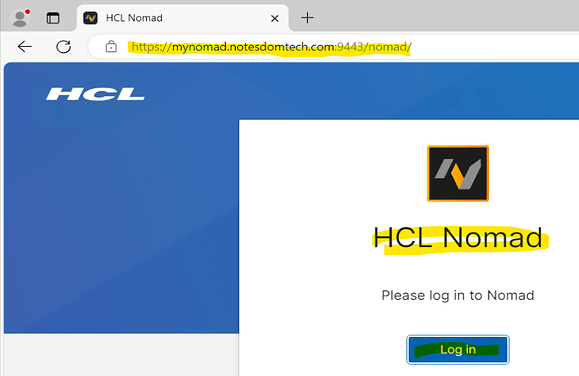

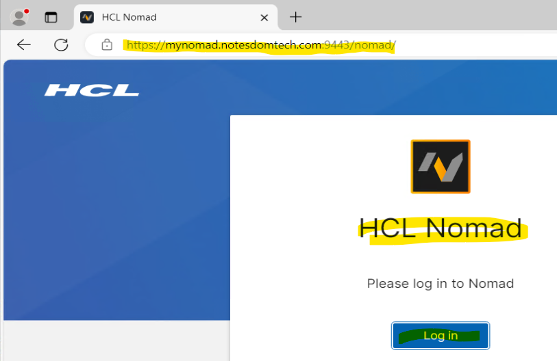

Browser URL accessed same as above host: https://mynomad.notesdomtech.com:9443

Yes, I am using certstore. The hostname listed there, and with credentials shown as valid, is identical to the one I am typing into the browser, and to the value of the Nomad_web_host notes.ini variable. The hostname is resolvable by DNS.

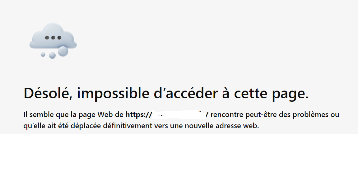

I observe the same behavior following upgradee from version 1.0.10 which works very well to version 1.0.13 IF2 or 1.0.14 ; see attachment for debug in release 1.0.14 , something is missing ?
nomad_debug.txt
Do you have the /nomad/ on the end of the URL in the browser (which you blanked over)?
You should probably open a support case so we can look at both client (https://help.hcl-software.com/nomad/1.0_web/nw_report_problem.html) and server logs from the same time. That will also allow the data to be handled confidentially (rather than posting in this public forum).

In fact yesterday I had to upgrade to the last version because new connection failed with errors like
https://support.hcl-software.com/community?id=community_question&sys_id=a71061bb93a9d2100dddf87d1dba10b1
I was facing same behavior unable to reach server through Https.
Like we are not using http on our Domino for nomad , our nomad-config.yml was filled with port to 443 not 9443 ; firewall for this port was open on Windows Server ,
so like error was closed to port not allowed , I made a new firewall rule for nomad executable on port 443 and what happened
can connect to nomad service now , hope this will help someone else.
