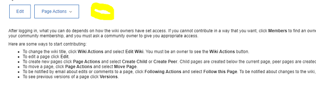

Hi,
i updated today my Testenvironment from V6.5CR1 to V7.
I complete the steps from the HCL Update Manuel. The Installation was successfully but i miss 2 Features.
1. Feature: I see no [PDF Export] Button or Option to configure in the Community Actions.
2. Feature: Also when i create a new Community the new Template Management is missing.

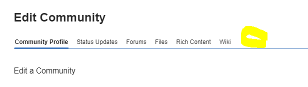

Did you enable the PDF export in the community properties? Go to "Manage Community" and there you have the option. (2nd screenshot of the original post by Max)
When loading the page, you can see an API call to acl.json. The result has an influence if the button is shown or not.
Unfortunately, if the ACL tells no but the feature is enabled in the Community, I have no idea how to fix this. I did not have this error yet.
Martin
The option is not visible. Neither in the Community Properties nor directly in the Community.
