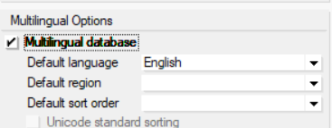

If the Template has multi lingual property set, is marked as a master template, when you create a database from this template, the database will have the multilingual flag set. also when you use Refresh Design, the design will get refreshed and database will remain multi lingual. I have tested it and it works perfectly as desired.
Please ensure the said database template is on server and you are refreshing the design from server, or it is on local and you are refreshing the design from local. Also ensure the Database file is a Master Template is checked in the template properties, the Template name is unique and the database inherits the desgn from this master template (in database properties of the database file).
Please watch for messages on the bottom left bar while design refresh is executing. are there any messages about conflicts or two templates claiming to be the master template (as entered in properties of your master template database)
I have checked with template on local and server both, and the design refresh process retains the multilingual flag as expected.
hope this helps

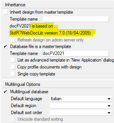

Thanks for the reply.
I think I found the problem which is related to my template.
Originally it was created from a Domino template.
Nothing is left from that template but somehow the link is left and this is causing the strange behavior with the multilingual flag.
I tried with a new template on a new database and it works perfectly as you say.
Sorry for wasting your time. Thanks a lot!

Just for your information: The information that is shown here is stored in a shared field called "$TemplateBuild". In this field the information is stored in the items "$TemplateBuild", "$TemplateBuildDate" and "$TemplateBuildName".
You can just remove this shared field to get rid of this information. Alternatively you can get the NotesDocument representing the shared field and manipulate these items using LotusScript.
The information about "multilinguality" is stored in the design element "Database icon". There it is in the item "$Flags" and represented by a capitol "M".
This Information can also be edited using LotusScript. Depending on the settings in the template the Database icon is set once on creation of a database or refreshed on every design refresh, just check the flags for deisgn protection on the database icon.
